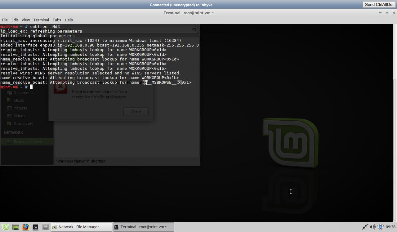

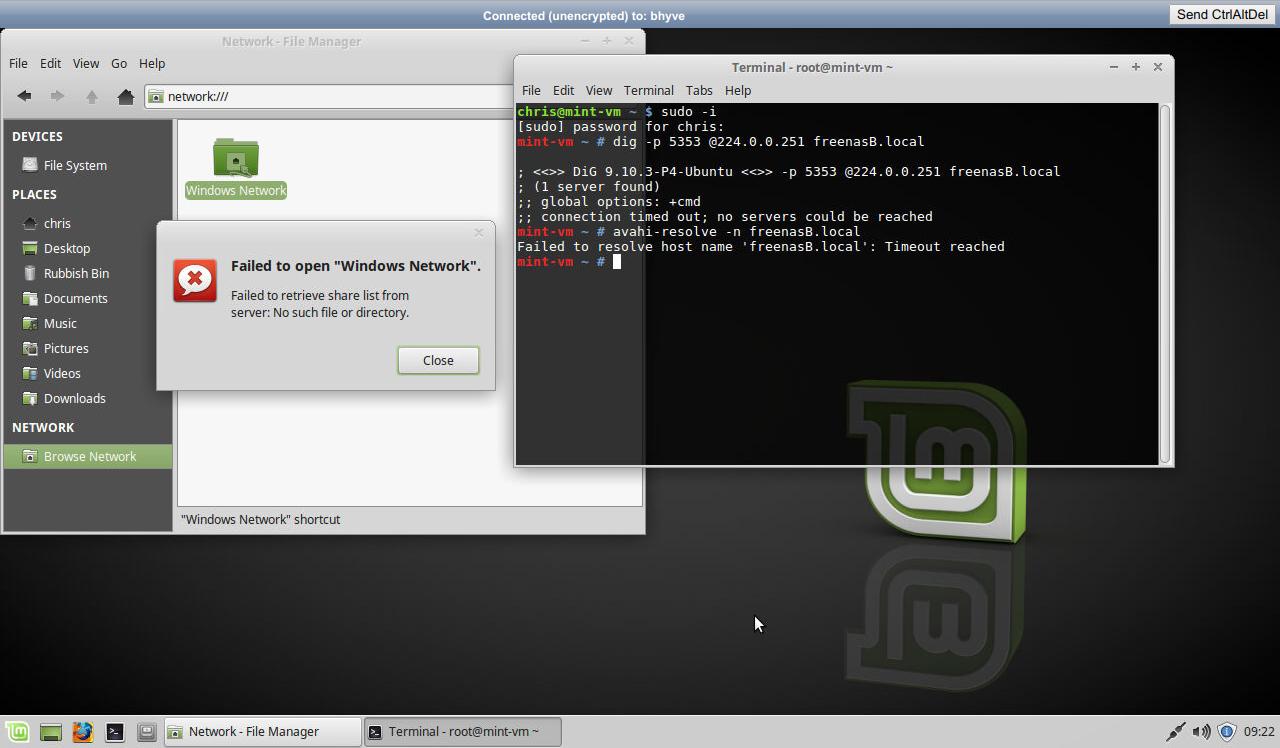

@Chris Moore I made time to return to this question. The failure to browse FreeNAS host samba shares from within a Mint VM appears to be due to the "name request" never reaching or being replied to by the FreeNAS SAMBA server.
Using smbtree in debug mode in the VM shows the "broadcast look up" fails - see pic below.
A simple packet sniff on the FreeNAS network shows the smbtree command generates NBT UDP packets on all the relevant interfaces but a response packet never appears, nor does the nmbd log show any incoming name request from the IP associated with the Mint VM.
root@freenasB:~ # tcpdump -i tap0 ether broadcast
tcpdump: verbose output suppressed, use -v or -vv for full protocol decode
listening on tap0, link-type EN10MB (Ethernet), capture size 262144 bytes
09:48:34.099872 IP mint-vm.47719 > 192.168.0.255.netbios-ns: NBT UDP PACKET(137): QUERY; REQUEST; BROADCAST
09:48:35.101421 IP mint-vm.57268 > 192.168.0.255.netbios-ns: NBT UDP PACKET(137): QUERY; REQUEST; BROADCAST
09:48:36.103245 IP mint-vm.53257 > 192.168.0.255.netbios-ns: NBT UDP PACKET(137): QUERY; REQUEST; BROADCAST
09:48:46.000146 IP sweep.3483 > 255.255.255.255.3483: UDP, length 26
^C
4 packets captured
13 packets received by filter
0 packets dropped by kernel
root@freenasB:~ # tcpdump -i bridge0 ether broadcast
listening on bridge0, link-type EN10MB (Ethernet), capture size 262144 bytes
09:49:03.495009 IP mint-vm.59623 > 192.168.0.255.netbios-ns: NBT UDP PACKET(137): QUERY; REQUEST; BROADCAST
09:49:04.498494 IP mint-vm.45294 > 192.168.0.255.netbios-ns: NBT UDP PACKET(137): QUERY; REQUEST; BROADCAST
09:49:05.501098 IP mint-vm.37849 > 192.168.0.255.netbios-ns: NBT UDP PACKET(137): QUERY; REQUEST; BROADCAST
^C
3 packets captured
19 packets received by filter
root@freenasB:~ # tcpdump -i em0 ether broadcast
listening on em0, link-type EN10MB (Ethernet), capture size 262144 bytes
09:49:23.378951 IP mint-vm.56691 > 192.168.0.255.netbios-ns: NBT UDP PACKET(137): QUERY; REQUEST; BROADCAST
09:49:24.381062 IP mint-vm.38718 > 192.168.0.255.netbios-ns: NBT UDP PACKET(137): QUERY; REQUEST; BROADCAST
09:49:25.382633 IP mint-vm.55875 > 192.168.0.255.netbios-ns: NBT UDP PACKET(137): QUERY; REQUEST; BROADCAST
When you use the thunar file manger to attempt to browse the smb shares it generates the same NBT UDP packets on the FreeNAS host. But as there is no server response, the error message "Failed to retrieve share list ... " appears - see pic 2 below.
Turning "zeroconf share discovery" on the FreeNAS SMB server does not help as both the relevant avahi-resolve and dig commands fail to resolve. Again the correct multicast packets seem to appear of the FreeNAS side, but there's no response.
root@freenasB:~ # tcpdump -i em0 ether multicast and host 192.168.0.90
09:59:03.667804 IP mint-vm.mdns > 224.0.0.251.mdns: 0 [2q] A (QM)? freenasB.local. AAAA (QM)? freenasB.local. (38)
09:59:04.675123 IP mint-vm.mdns > 224.0.0.251.mdns: 0 [2q] A (QM)? freenasB.local. AAAA (QM)? freenasB.local. (38)
09:59:06.680139 IP mint-vm.mdns > 224.0.0.251.mdns: 0 [2q] A (QM)? freenasB.local. AAAA (QM)? freenasB.local. (38)
^C
3 packets captured
7235 packets received by filter
09:59:36.788403 IP mint-vm.59356 > 224.0.0.251.mdns: 27831+ [1au] A (QM)? freenasB.local. (43)
09:59:41.794803 IP mint-vm.59356 > 224.0.0.251.mdns: 27831+ [1au] A (QM)? freenasB.local. (43)
10:00:30.158576 IP mint-vm > igmp.mcast.net: igmp v3 report, 1 group record(s)
10:02:35.696111 IP mint-vm > igmp.mcast.net: igmp v3 report, 1 group record(s)
