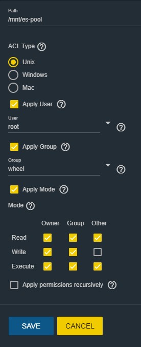

After updating to FreeNAS-11.2-U7 (previously version U6), I don't have access to network resources (SMB folders) from computers not connected to the AD. However, when trying to connect a resource, the login window shows up, but after entering the domainname\username and password nothing happens. The login window appears once again as if there is no access for this user. On computers in the domain the same login data works fine.
The freenas server is attached to the domain and synchronized with AD.

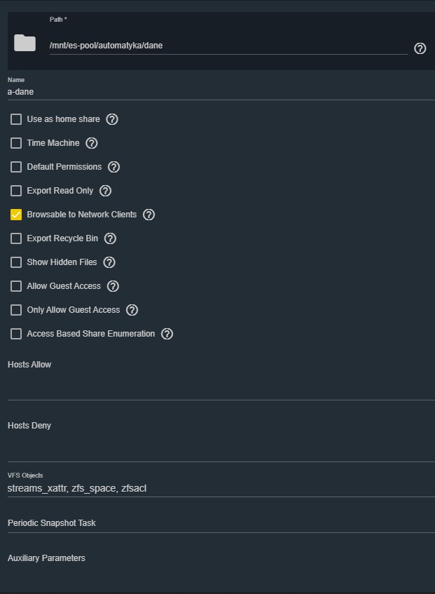

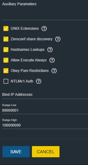

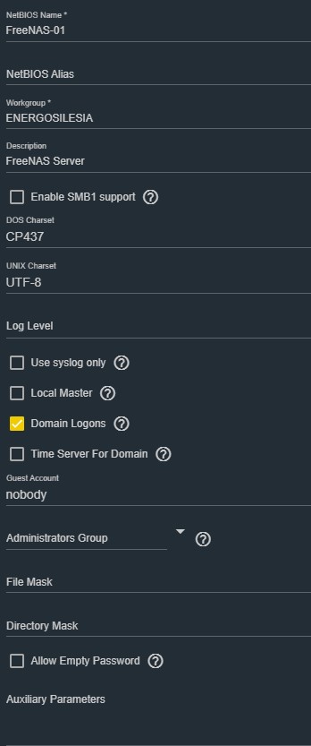

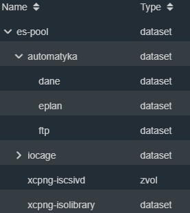

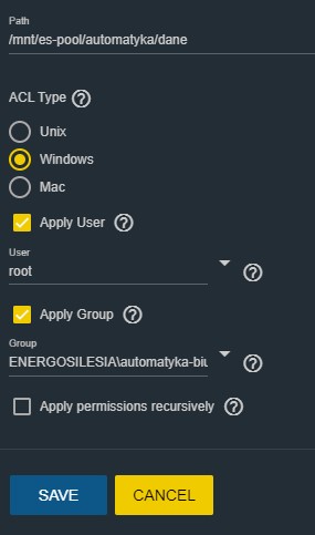

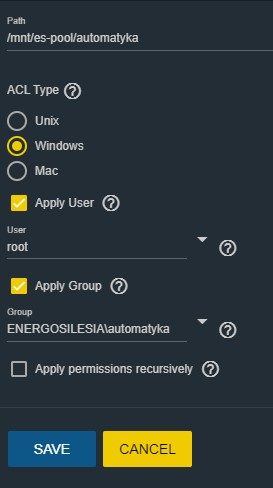

widuchd
Jan 8, 2020
5
I have the settings as in the attachments.

MikeyG
Dec 8, 2017
442
I assume the client is a windows 10 PC? Could you share screenshots of what you are doing and the error?
You've tried making sure credentials are wiped out in credential manager? Have you tried any other Windows 10 devices?
I've also sometimes noticed that smb sessions can get "stuck" in Windows (not sure how to describe this) but often when testing access, I will alternate between the domain name of the server and the IP as this establishes a new session (or reboot). Or try another Windows test machine.
Also check the security permissions of the share in windows to make sure it's what you are expecting.
