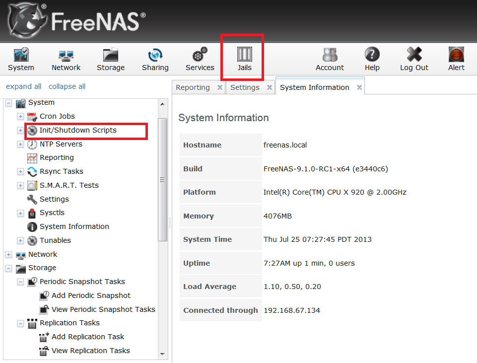

Normally I'd say "its a bug" but something else is wrong. Your icons aren't the 9.1 icons that have been there for weeks and weeks. I almost want to think that you have an 8.3.1 screen open but have the wrong shell from another server overlayed on accident.
The first 9.1 I played with had the new icons, so either your version of 9.1 is very very old and shouldn't be used or you are confusing one window with another and the screenshot is somewhat deceiving.

I'm wondering if you tried to do a GUI upgrade from 8.3.1 to 9.1. GUI upgrade isn't supported because the partition size changed from 1GB to 1.8ish GB with 9.1. Your system could be the result of a failed upgrade due to running out of disk space.
I know you said you used the same ISO, but something is terribly wrong. Somewhere something is confused, and its NOT an ISO issue.

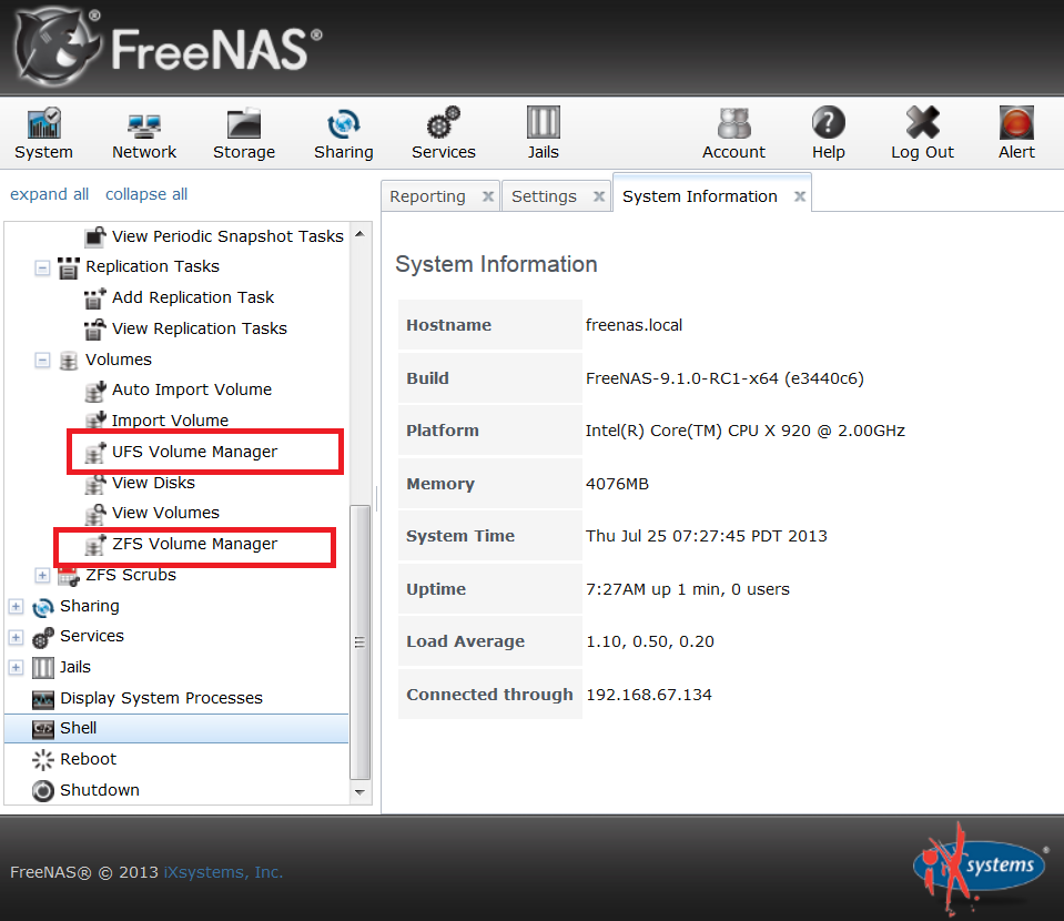

Here's what 9.1 looks like to me... notice the different icons and layout. The stuff in red doesn't exist in 8.3.1, and you don't have it...
Edit: I just downloaded the ISO and installed it in a VM to take those pictures...
You shouldn't be dealing with any GUI errors. 9.1-RC1 has been pretty flawless so far based on my experimenting with it....
Try wiping the USB stick and installing again. This will make sure the ISO doesn't try to "upgrade" anything.
