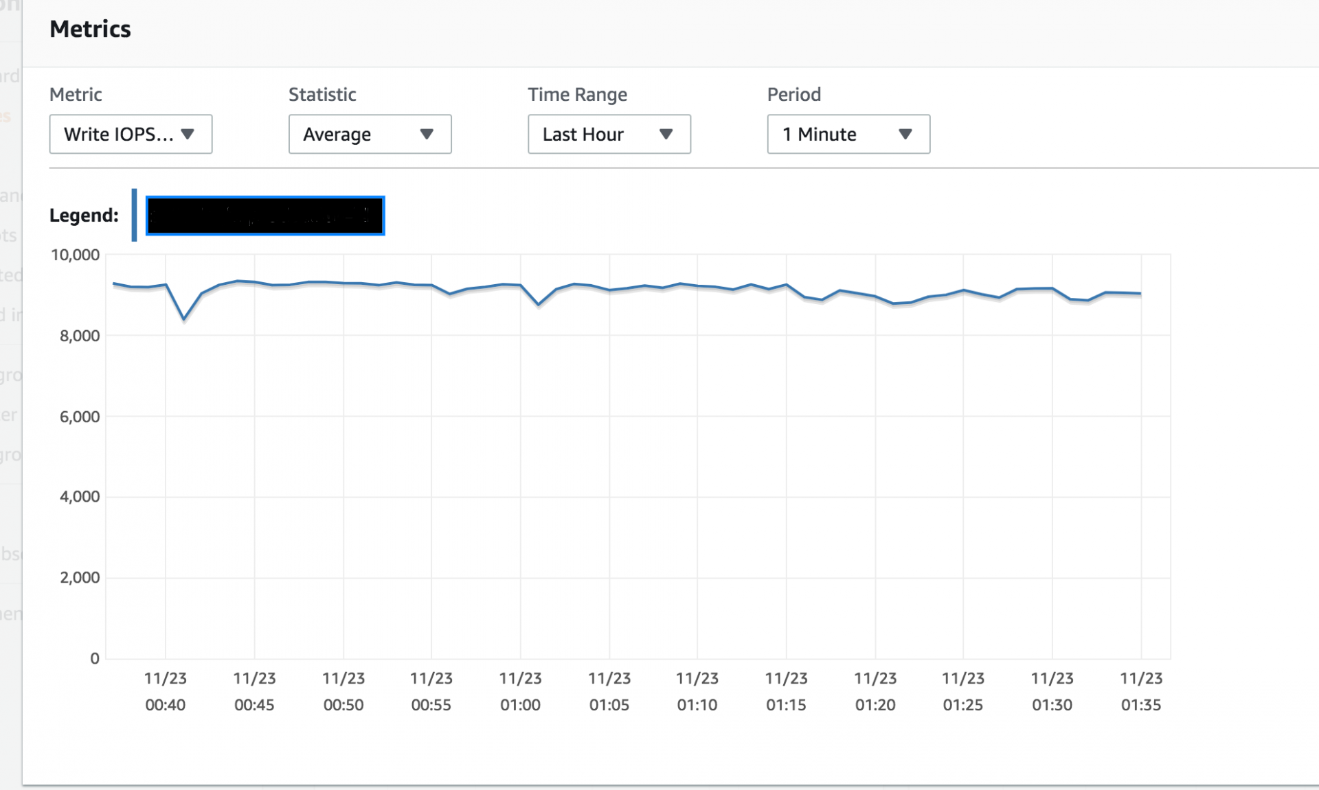

Hello All,
i use Freenas a Long time for some Projekts but now i have a new "Quest".
Our Customer want to step back from AWS to local Servers.
We want to made a 4 Node Proxmox Cluster with Supermicro Twin Servers.
Each Node has 1TB Ram and we Need a maximum an write Performance for MariaDB.
At the Moment the Customer used Amazon RDS with over 8k IOPs.
85% Write and only 15% Read.
So i Need a fast Freenas Storage Server.
  • Supermicroserver 2029U-E1CR4T with dual Intel Xeon Bronze 3104
  • 2x 64GB SataDom for the System
  • 128GB ECC Ram
  • 24x Crucial MX500 2TB SSD
Wich Pool Config is prefered for this Szenario?
Do i Need a Slog for this Action?
Thanks for your Advice!
9,700
You haven't given any guidance on requirements for fault tolerance... if you just want raw speed, you can just stripe the SSDs and probably have over a quarter million IOPS... if your network can handle that. Seems like (25x) overkill looking at the chart.
