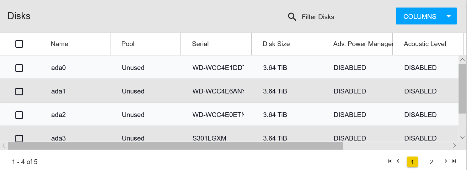

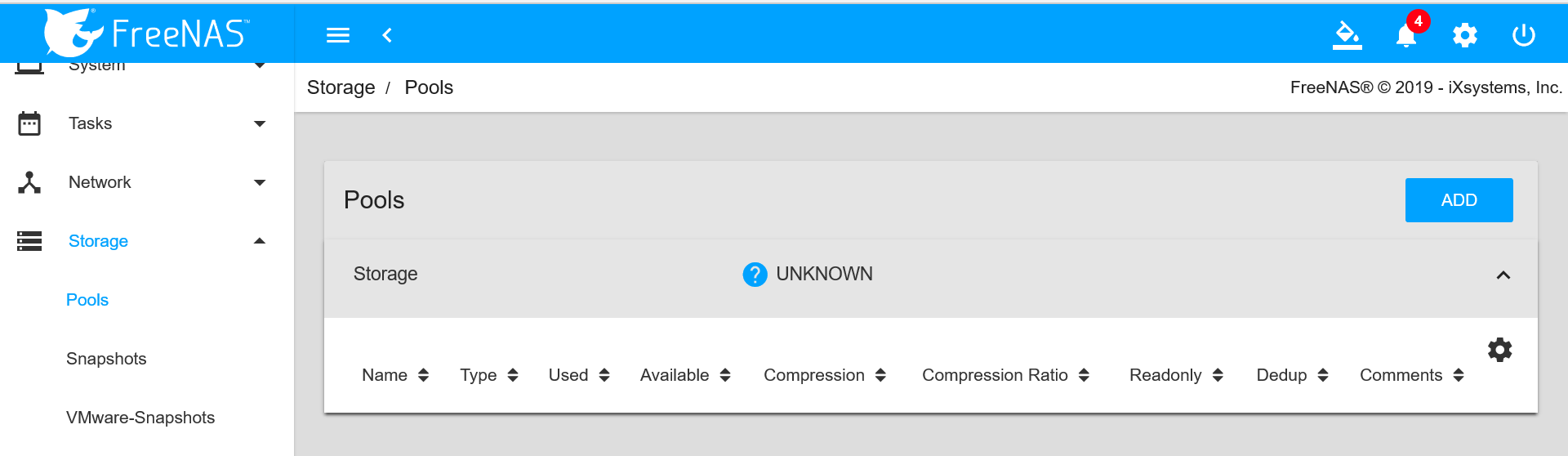

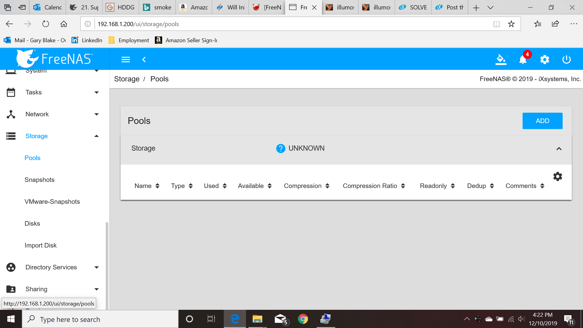

Had a power outage while I was away that ran down the UPS and crashed the NAS system. On rebooting my zpool is now unavailable and 2 of my 6 drives are no longer showing in the Storage-Drives view

I took the two drives that are UNAVAIL and connected them to my laptop via a USB to SATA cable. The drives are discovered but show as uninitialized. Looks like the partition information is corrupt. The zpool was set up as a RaidZ2 so I should be able to survive a 2 drive loss right? Really need to get these back up and running as they contain Tax information :( - Yes I should have a back up but I am an idiot -
Any help would be extremely helpful. I have been racking my brain on this for 2 days now.
