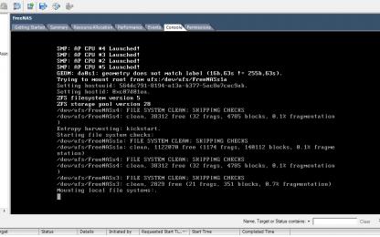

Here are some screengrabs. The first is where it hung, the second and third are me hitting control-t (once, and then as many times as I felt necessary :)
cmd: zpool 579 [zio->io_cv)]152.10r 0.00u 0.05s 0% 2520k
I also forgot to mention that there is nothing on the volume right now, I've erased it and started over numerous times.

That makes it appear as though the system is hanging on I/O to your controller. PCI passthrough is kind of dependent on all the bits being designed correctly and working together. Your system may be experiencing a problem with how interrupts are being handled, or something equally obscure, that makes it almost-work.
