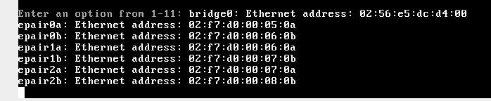

But once I upload my saved configuration and the server goes though the reboot, after a short time the server hangs-up completely requiring a hardware power-off. Using an IPMI connection to see the "server screen", I see that the following appears after a short period of time, and this is when it crashes:

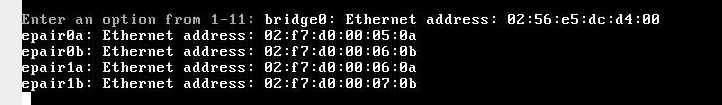

and on another try:

EDIT: Due to fast work with keyboard and mouse, I was able to login and set all Jails to Down before the server crashed again. This stopped it from crashing! I then edited the Jails and disabled Auto-Start, and then rebooted the server. The server boots and I no longer get the bridge and epair messages on the console. So must have been linked to my Jails somehow.
