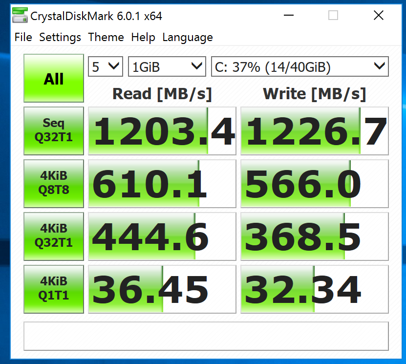

Hello! I'm a relatively new user to FreeNAS, and wanted to share an issue I had recently. I use my appliance for mostly iSCSI duties to serve as backend storage for a few ESX VM hosts. While the hardware varies (in both generation and brand) between all of these components, pretty much everything uses an Intel X520-DA2. Originally selected the 2 port variants to reserve one port for iSCSI and the other for Management/Shares (Not iSCSI)/etc.
While 10gbps is a little overkill for home, the cables/adapters are getting fairly inexpensive, and had scored a deal on a Quanta 24 port SFP+ switch about a year ago. At the time, my storage couldn't saturate it, but 10g simplified the cabling a bit, eliminating the need for link aggregation for the most part on my servers. Last fall, I rebuilt my storage server using FreeNAS. I have been very pleased with the performance and functionality, though when I finally got around to benchmarking the storage subsystems from a windows VM, noticed that CrystalDiskMark (quick and dirty testing) was reporting around 524MB/Sec read and 1194MB/Sec write. While this isn't slow, it struck me as odd that both HDD and SSD Datastores were reporting about the same level of performance.
The VMWare datastores correspond to the HDD/SSD pools, each with 8 drives in a mirrored/striped volume. I've added zvols on top of those, and attached them as devices to iSCSI targets. Adding them to ESXi was a breeze!
Anyway, after much testing, I ended up punting a bit and swapping the X520-DA2 in the FreeNAS appliance to an X710-DA2 and noted much improved performance on the TX front. Question -- has anyone seen something similar? Have done a bit of searching around the forums and google/bing, but so far been pretty inconclusive. Are there any tunables I may have missed?

Troubleshooting
- Swapped FreeNAS iSCSI port Twinax cable to another known good.
Result: No Change
- Found that FreeNAS motherboard is only PCI-E 8x on Slots 7 & 8 (Closest to CPU). The remaining ones are 4x, while the connector is 8x.
X520-DA2 is PCI-E 2.0 8x
Was in 4x slot; moved to 8x slot; moved expander to farthest slot from CPU, Slot 4.
Result: No Change
- Purchased x710-da2 for FreeNAS **
Swapped adapters, ended up appearing as separate NICs, deleted originals, and reconfigured new to match original.
Result: Much improved performance for TX on FreeNAS
opt/iperf/bin/iperf -c 172.16.192.21 -t 60 -i 15 -r------------------------------------------------------------Server listening on TCP port 5001TCP window size: 64.0 KByte (default)------------------------------------------------------------------------------------------------------------------------Client connecting to 172.16.192.21, TCP port 5001TCP window size: 256 KByte (default)------------------------------------------------------------[ 5] local 172.16.192.15 port 56773 connected with 172.16.192.21 port 5001[ ID] Interval Transfer Bandwidth[ 5] 0.0-15.0 sec 17.3 GBytes 9.89 Gbits/sec[ 5] 15.0-30.0 sec 17.3 GBytes 9.89 Gbits/sec[ 5] 30.0-45.0 sec 17.3 GBytes 9.89 Gbits/sec[ 5] 45.0-60.0 sec 17.3 GBytes 9.89 Gbits/sec[ 5] 0.0-60.0 sec 69.1 GBytes 9.89 Gbits/sec[ 4] local 172.16.192.15 port 5001 connected with 172.16.192.21 port 49812[ 4] 0.0-15.0 sec 17.3 GBytes 9.89 Gbits/sec[ 4] 15.0-30.0 sec 17.3 GBytes 9.90 Gbits/sec[ 4] 30.0-45.0 sec 17.1 GBytes 9.81 Gbits/sec[ 4] 45.0-60.0 sec 17.2 GBytes 9.83 Gbits/sec[ 4] 0.0-60.0 sec 68.9 GBytes 9.86 Gbits/sec
