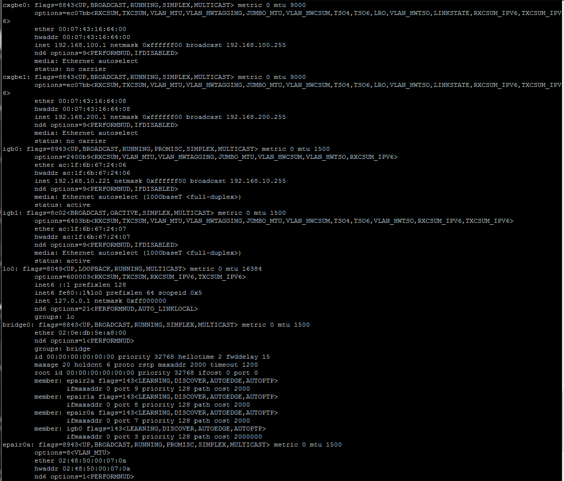

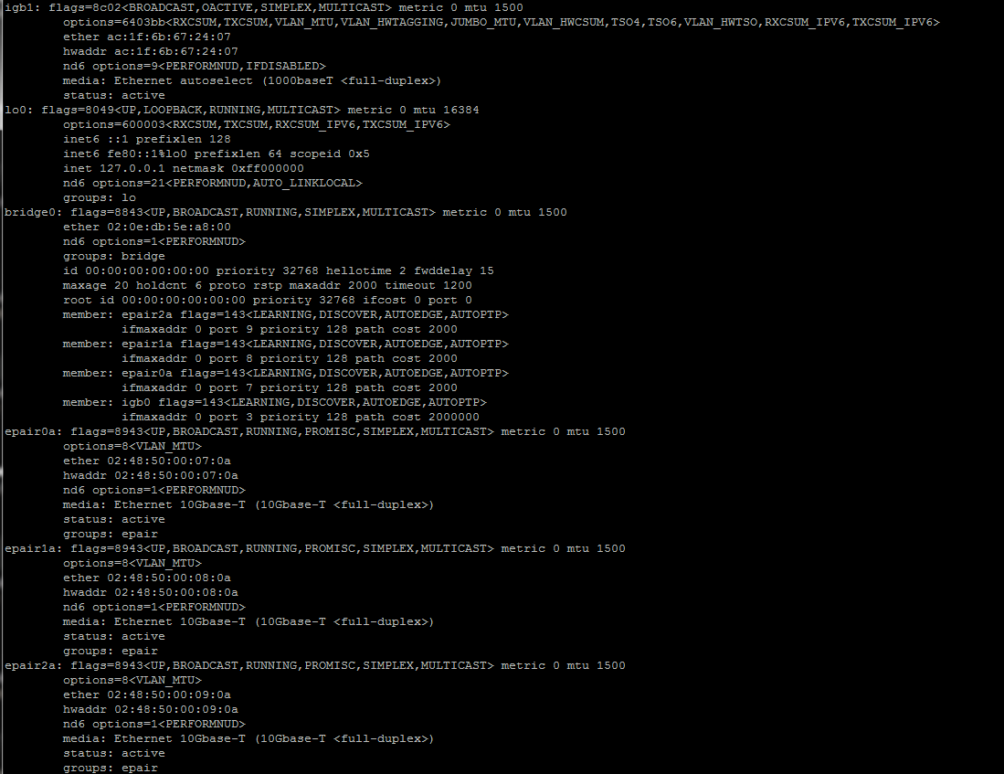

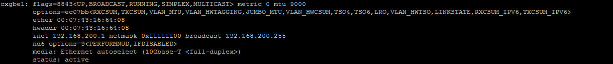

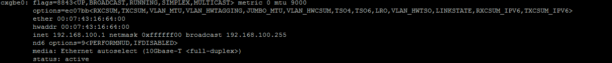

I couldnt get the code tags, but I did get screenshots of various parts of the system, both when it was working and when it wasnt. The ifconfig png is all of the config while the 10g is down. The other 2 config pics show when each interface was accepting data. (on the win 7 and win 10 subnets respectively).

update:
So i did some testing today and got the 10G stable. It is now staying up, however, I can no longer connect to plex. When i check the ifconfig the epair connections are defaulting to the 10g connections... but plex is set to route out the regular gigabit connection (selected nic. vimage off. static ip). additionally, it will no longer start or stop throught the GUI and in the shell I recieve an error "No more processes" when I attempt to start or stop the service along with any other plugin's
