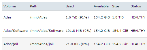

So, I was having some problems with my plugins not working so I got the suggestion to enter more RAM and install the 64-bit version. Since the current setup couldn't use more then the 2Gb I had I moved the drives and USB to a new machine with more memory. Installed the 64-bit one (upgraded) and everything seemed to work.
Atleast until I installed the Jail and plugins, then I noticed that my folder for downloads was missing a bunch of my files that I had downloaded earlier and going to the storage settings I noticed that it said my drives now only was 720Gb
Old Stats:
Stats after move:
It doesn't seem that the folders used for backup is effected but only my "Share" folder for transmission (Atleast I hope) and the only thing I did was remove the mount point associated with the plugin since I couldn't install the new one with it still there. Mount Points should only be virtual paths for the plugins right...
Anyway, since it's showing the wrong size I hope my files are still there somewhere but how can I get it back?
Old Stats:
Stats after move:
