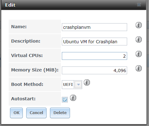

Using the FreeNAS GUI, create a new VM, using the following settings:
-->Name: CrashPlanVM
-->Description: Ubuntu VM for Crashplan
-->Virtual CPUs: 2
-->Memory Size (MiB): 4096
-->Boot Method: UEFI
-->Autostart: (untick)
I would recommend 2 CPUs, if you have available CPU resources. I haven’t performance tested 1 vs 2 vs 4, but with 2 CPUs just during setup I’ve seen loads above 2, and sustained 1.0X during file synchronizing.
“Code42 typically recommends allocating 1 GB (1024 MB) of memory per 1 TB of storage (or per 1 million files).” https://support.code42.com/CrashPla..._settings_for_memory_usage_with_large_backups
The Memory Size of the VM should be about 1GB higher than the amount of data you want to back up in Terabytes. ie: if you are going to backup 8TB of data, set it to 1024*9 = 9216 MiB. This leaves 1GB of headroom for the OS. You may want to add even more if you have plans to use this VM to run other jobs.

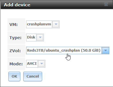

You now need to add some “devices” to the VM, the first of these is the hard-disk storage (i.e. zvol) you created in Step 6. Add a device using the following settings:
-->VM: CrashPlanVM
-->Type: Disk
-->Zvol: /mnt/Reds3TB/ubuntu_crashplan
-->Mode: AHCI

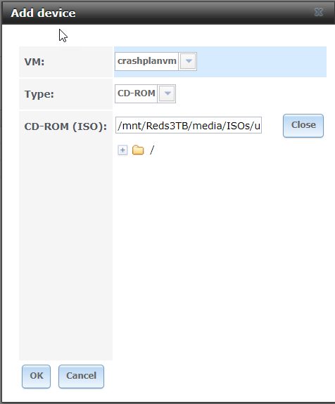

Next add a bootable CD-ROM to the VM, so that it can access the install .iso. Add a device using the following settings:
-->VM:CrashPlanVM
-->Type: CD-ROM
-->CD-ROM (ISO): /mnt/Reds3TB/media/ISOs/ubuntu-16.04.3-desktop-amd64.iso

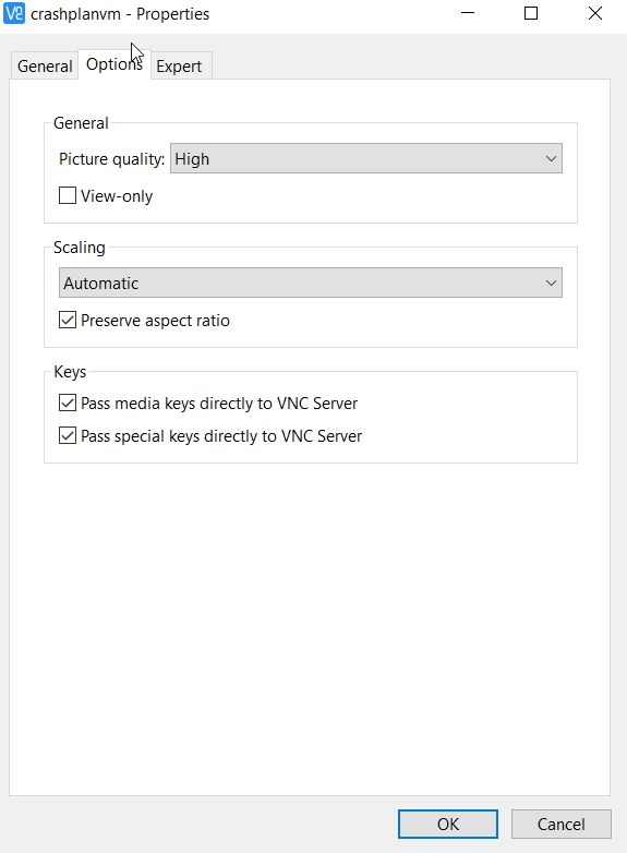

Ensure you have a VNC application installed on your computer (not FreeNAS or the VM). I use VNC Viewer by RealVNC. TightVNC is also good.
Step 7
You now need to select and start the VM, once started you then need to connect to it via VNC. The IP number is the same as your FreeNAS server, and the port number is displayed in the "Info" box on the VM overview page in the FreeNAS GUI.
At the moment, the VM won’t actually start until you connect to it via VNC (we will change this setting later).
For example, if the IP address is 192.168.1.100 and the port is 5901, you connect to 192.168.1.100:5901.
Set the quality level (under Options in VNC Viewer) to High to avoid “RFB protocol error: invalid message type 254”. (https://forums.freenas.org/index.ph...rror-connecting-via-vnc-at-linux-setup.54582/)

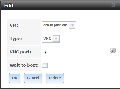

Edit the VNC device and untick "Wait to boot" (this means it will now boot automatically and not wait for a VNC connection).
Edit the VM and tick Autostart (this will ensure that the VM starts automatically on a FreeNAS server reboot).
Once you have made the above changes, you can restart the VM.

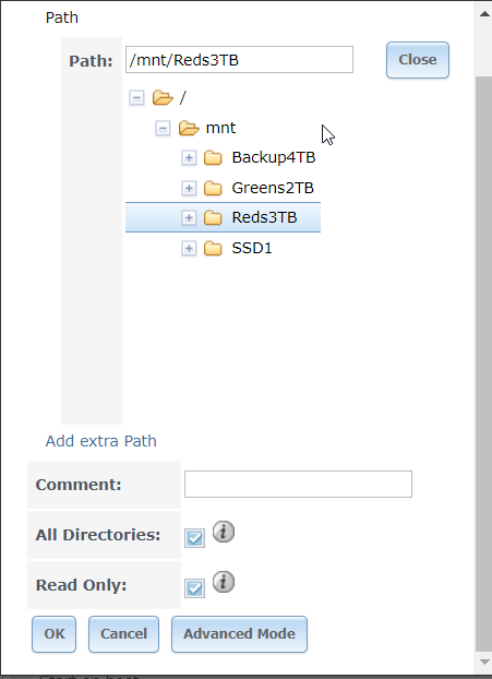

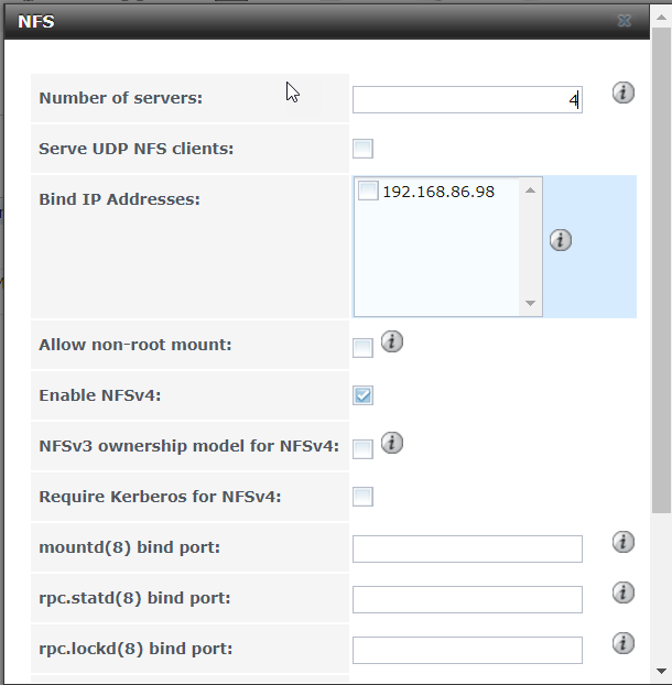

We are now at the stage where we want to share the volume(s) we want to NFS mount to the Crashplan VM.
In the FreeNAS GUI, select Sharing -> NFS -> Add Unix (NFS) Share
Define the path you want to mount (aka the top level of the data you want to backup), and click All Directories and Read Only options:

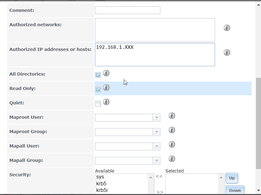

Optional:
Click Advanced and lock down the NFS share to just the IP of your Crashplan VM. Don’t do this if you are on a DHCP network, because the IP of your Crashplan VM might change when it reboots.
Select OK and Yes to the “Do you want to start this service” pop up.
Repeat this step for as many individual paths that you want to present to the Crashplan VM to backup.
Optionally, you can share the root of each of your volumes and do the choosing of what to backup in the Crashplan GUI. This is what I am doing in my example above.

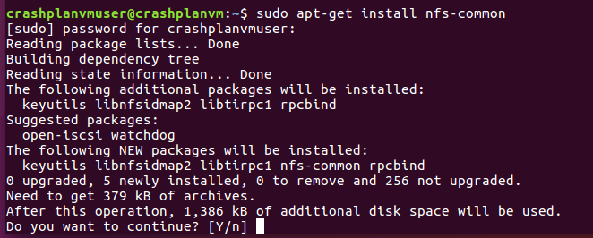

On the Ubuntu Crashplan VM we need to ensure NFS client packages are installed:
$ sudo apt-get install nfs-common
Press “Y”. This should only take a few seconds to install.

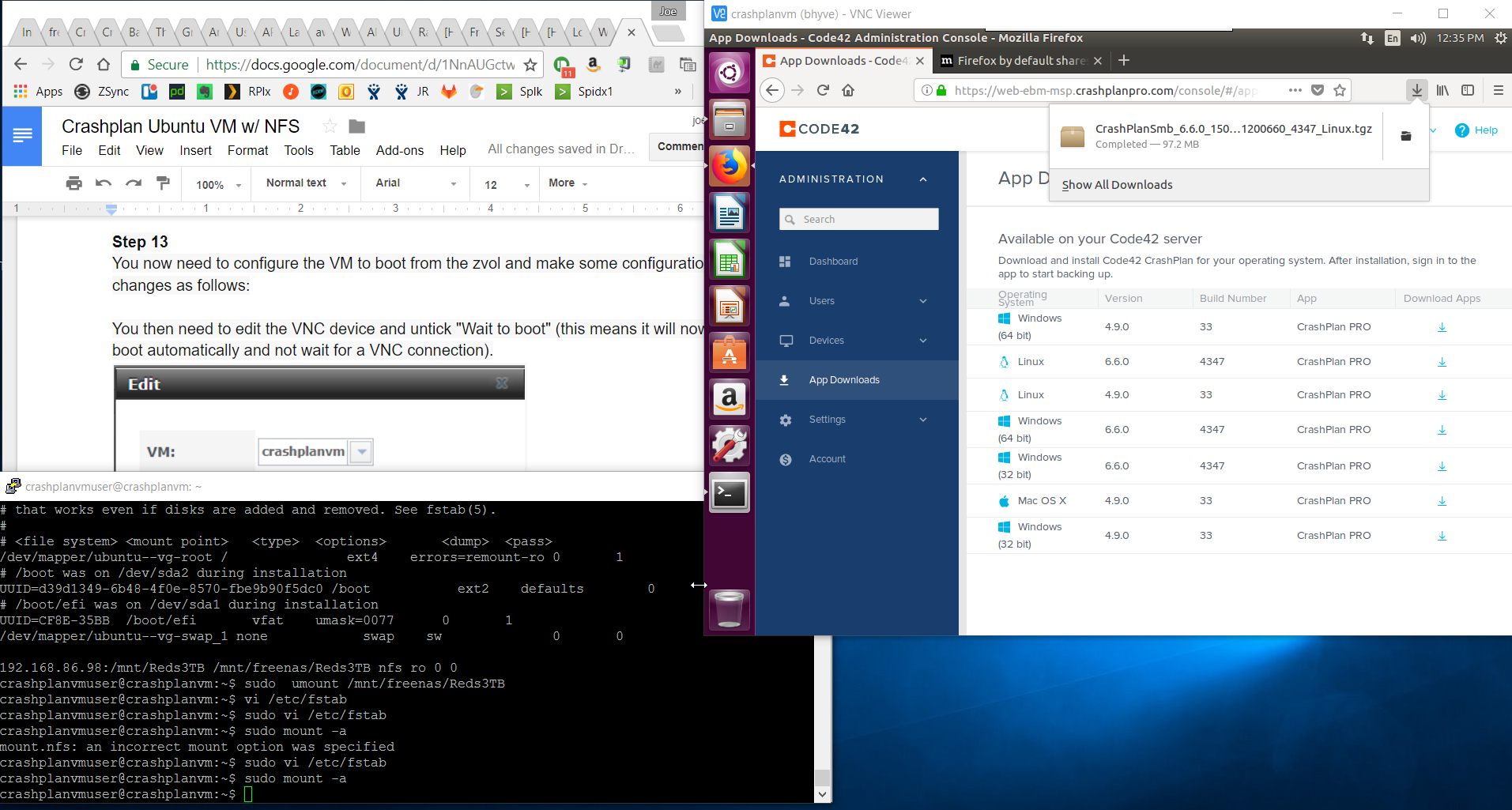

Go ahead and cd into the folder and look around. If you are on the VNC Desktop, you can browse there using the Files app.
Hopefully you’ll have access to all your files. If not you might need to tweak the file and folder permissions in your share. (If people have permissions issues in the forum, I’ll add some optional steps here).

In the Crashplan VM VNC session, load Firefox and navigate to https://www.crashplan.com, find and click Download, then select Linux version 6.6+, and save the file.
Either from Putty or the terminal in the VM:
$ cd Downloads
$ ls CrashPlan*
CrashPlanSmb_6.6.0_1506661200660_4347_Linux.tgz
