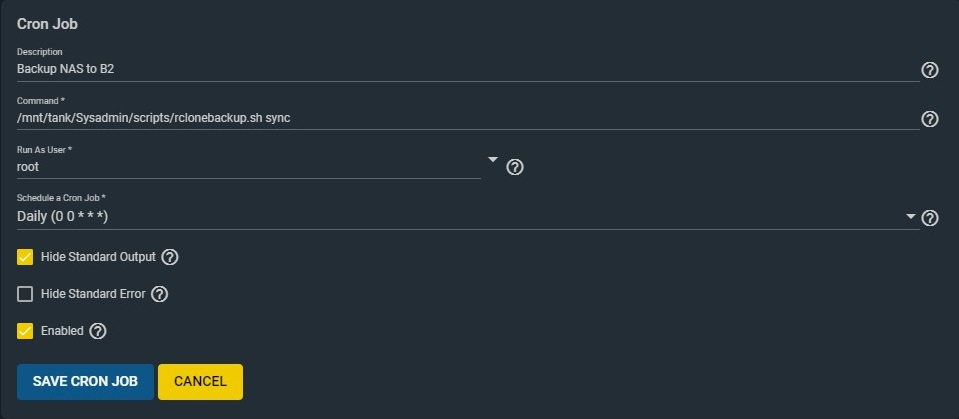

You now want to create a new cron job task via the FreeNAS GUI, remembering the command you want to run is the full path to the rclonebackup.sh script, with the parameter of sync or cryptcheck or check:
I recommend that for the first time you run this, that you do not enable the task. This is because the first run could take some time, many days if you have a few TB to backup. You do not want the server starting a new task while the old one is still running, as this will only confuse the backup process and slow down your server.
So, for your first time, just select the task and select Run Now, i.e.
Note: If the FreeNAS server reboots at any time during this first run, then you will need to restart the process by selecting Run Now again. This will re-scan the files and continue from where it last got to.
Step 6
Once the backup task has completed you should receive an email, along with a log file (of any errors encountered).
You can now edit the cron job and tick the Enabled box, so that the task will run automatically at the times you want. You may also want to edit the rclonebackup.sh script to change the log-level to INFO at this stage.
