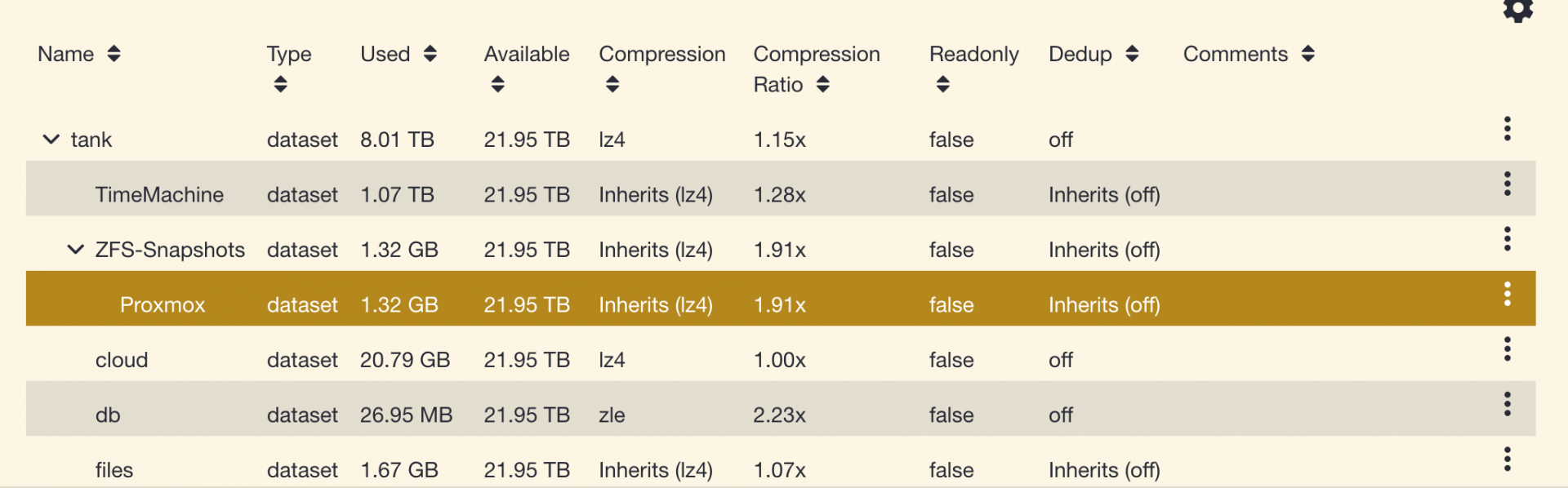

Here is a list of my specific zfs dataset
#zfs list tank/ZFS-Snapshots/Proxmox 1.31G 22.0T 1.31G /mnt
Why is it mounted at the /mnt mountpoint? How can I change this? I set the dataset up with the GUI. I can't access the dataset on the command line or remount it or frankly even access the dataset...for example. I can't delete it on the FreeNas GUI
# zfs set mountpoint=/mnt/tank/ZFS-Snapshots/Proxmox tank/ZFS-Snapshots/Proxmox
cannot unmount '/mnt': Device busy

Within tank I have multiple datasets. I created the datasets with the GUI
One of the datasets I created with the GUI was tank/ZFS-Snapshots/Proxmox. You can see this listed in the picture above. My belief is that this should be mounted at /mnt/tank/ZFS-Snapshots/Proxmox.
The problem is that Freenas or zfs or some process screwed up. I wasn't creating anything on the command line. Unfortunately the tank/ZFS-Snapshots/Proxmox datapoint is now mounted as /mnt.

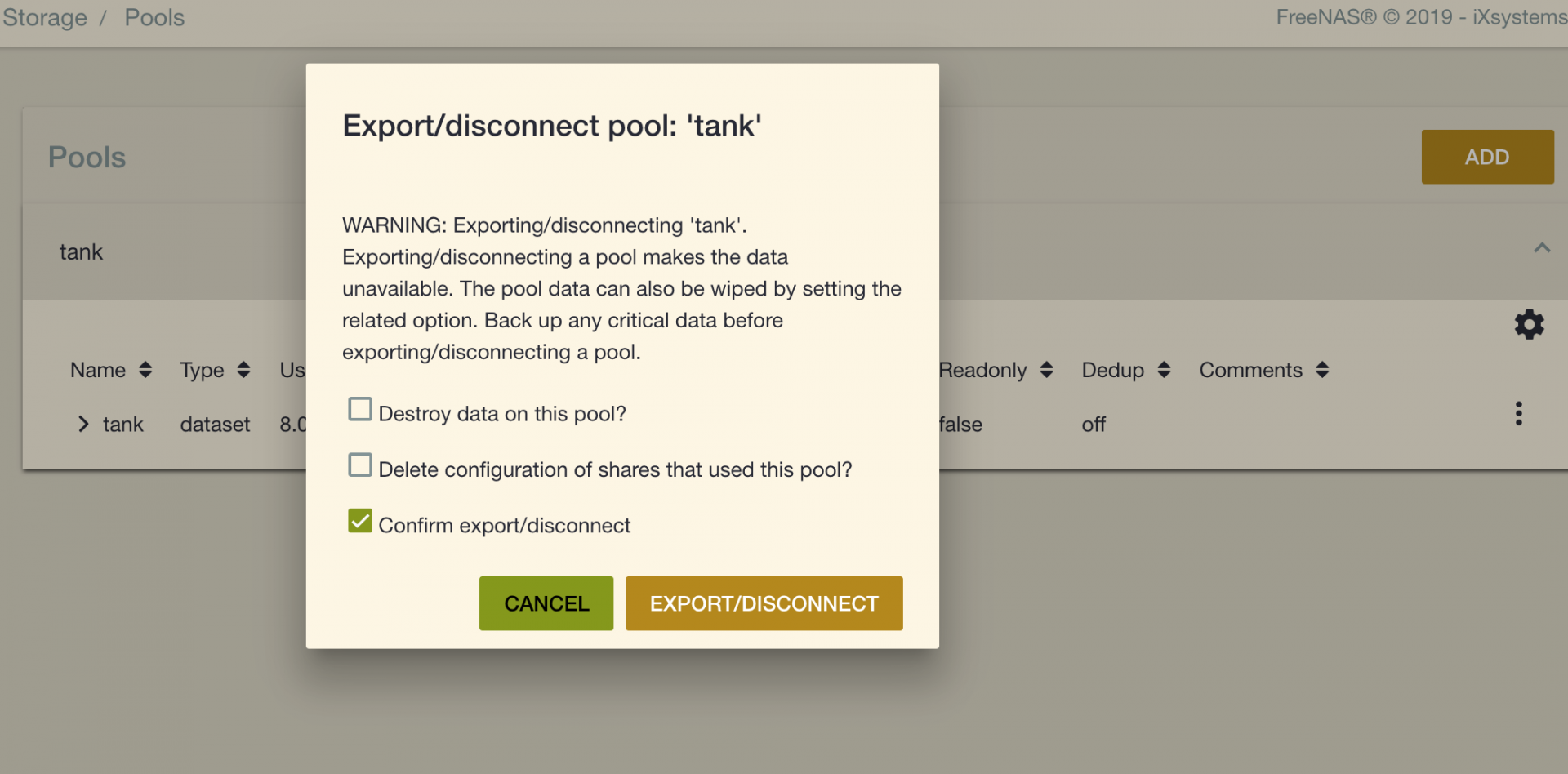

PS. also, do not delete the share configuration. If you export the pool without deleting share config, you just stop and start the SMB service to get the share back working.
KevDog
Nov 26, 2016
462
I see what you are talking about -- this is my main pool. There is no other pool. Is this what you want me to do? And how do I reconnect the pool?
Chris Moore
May 2, 2015
10,079
KevDog
Nov 26, 2016
462
Ok -- I exported and reimported the pool, however its at the same point. Still mounted at /mnt. I tried the zfs set mountpoint command however keep getting the error:
