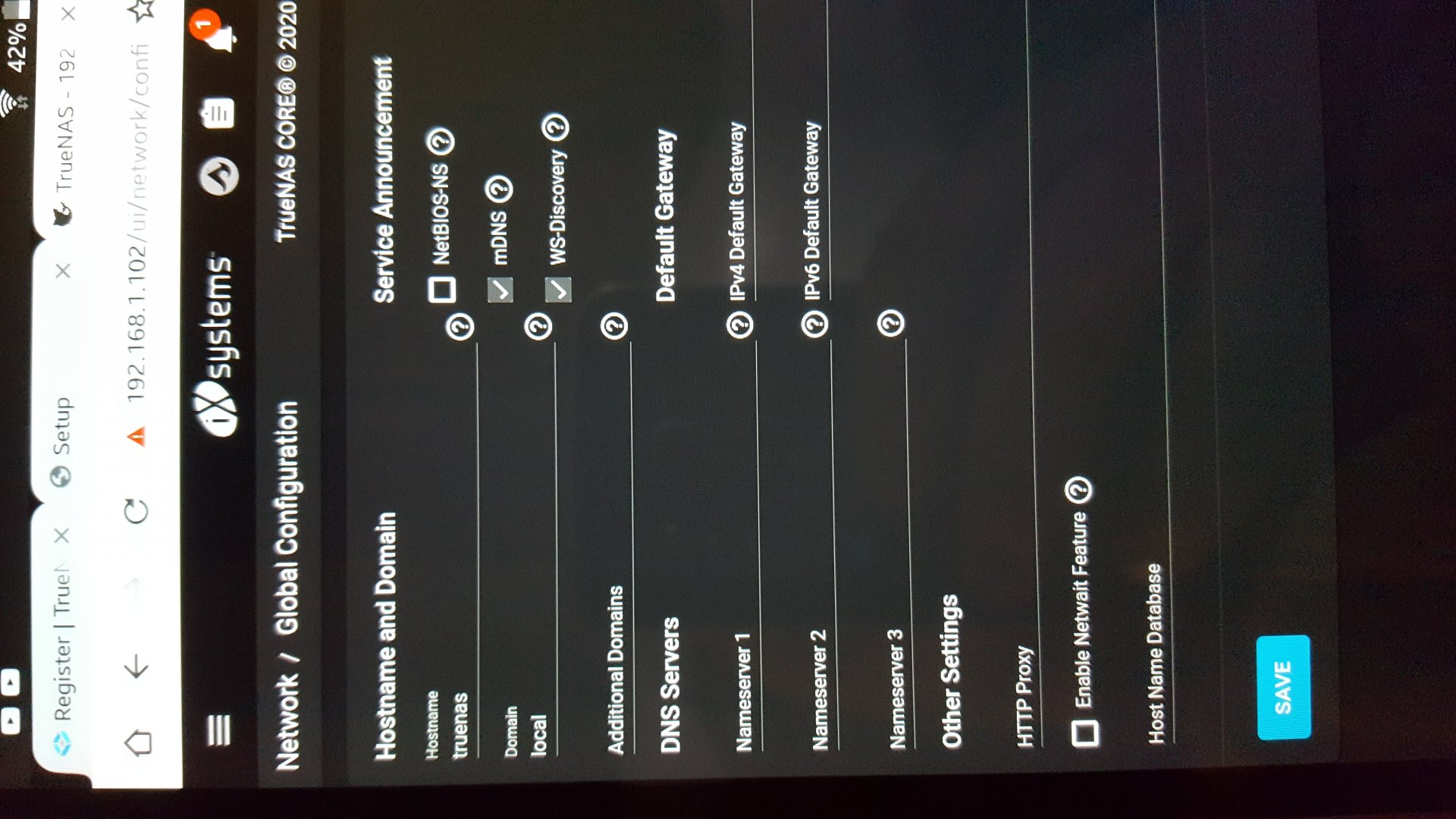

Nope.. i havent got a dns listed.. where do i find out the address i need to put in there? Do i find this information in my router settings?

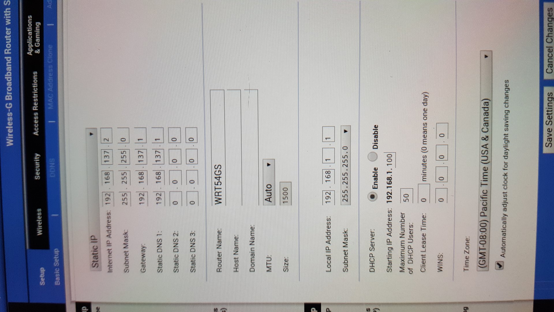

This is how my router is configured..

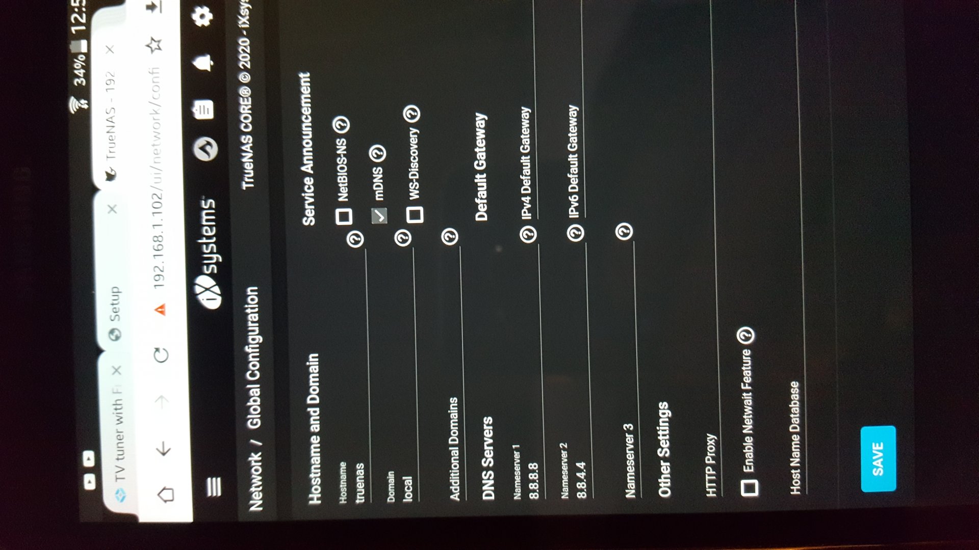

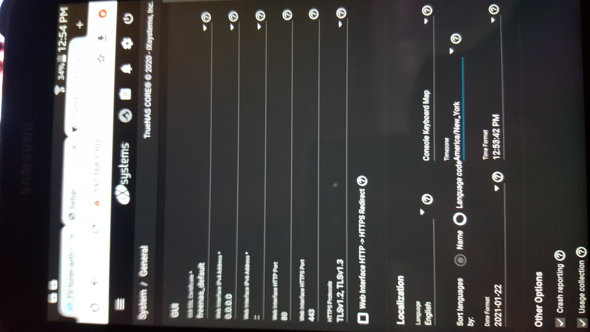

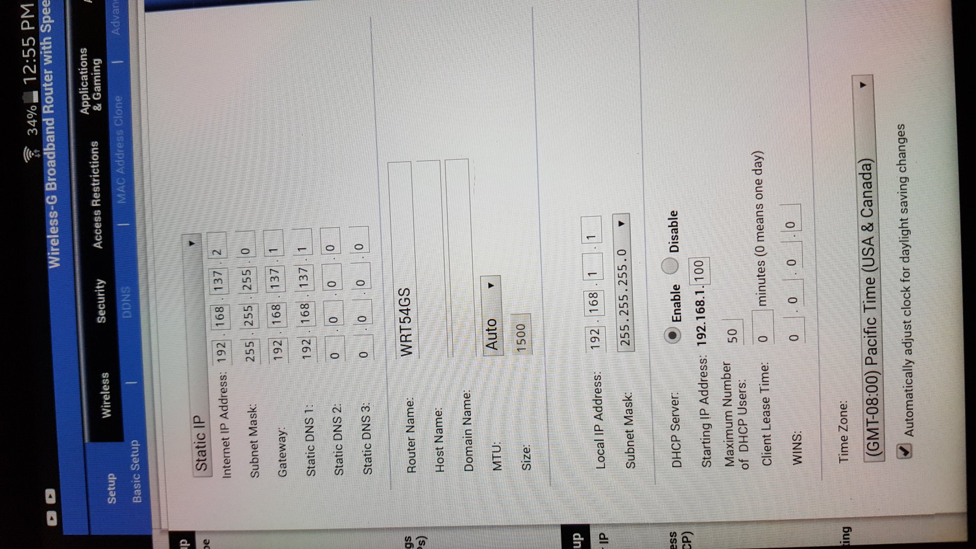

Did not work for me.. heres pics of everything i can thing of. Im sure i got something buggered up some where
