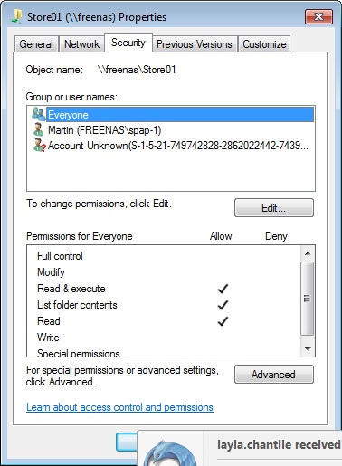

nah, after reboot - freenas struggles again - cifs accounts is not recognized (on this occasion the general group shows up as Unknown Account S-xxxx
...and the Deadlock sam_rids_to_names: possible deadlock - trying to lookup SID S-xxx is displayed on the console
Checked the permission set on subfolders and they all have the same issues - individual user permissions seem to be ok even though they dont end up being resolved by name
The other account shows up ok - most annoying :(

PM me a debug file. "System -> Advanced -> Save Debug". I think (barring some sort of obvious misconfiguration) the best course of action may be to create a bug report and make sure this problem is still on jhixson's radar.
View attachment 8060 View attachment 8059
Fixed in a veyr recent update. Update to the latest and it should start working.

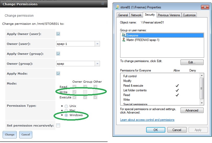

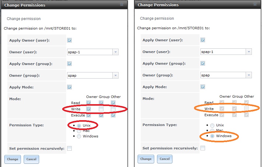

new install and deadlock reappears - group accounts unresolved i.e no change :confused: - what the,,,,?
Another weird thing is that when I set the default permission at root level on my volume (me (= full access, group (read+execute only)) - show up ok if I opt for Unix Permission type, BUT as soon as I switch to Permission Type = Windows my default permission changes where the group now gets full access as well - this is weird and starts to feel somewhat painful
Worth mentioning is that whatever permission type I opt for I check the Set Permission Recursively
Accessing my share from windows also reports the group account being granted full access
Is 9.3 actually stable or ...? - Don't feel like it is! :(
- This time around nothing has been inherited from old installations i.e fully based on a brand new clean install !
- all I've done once the installation completed was to add one of my volumes and the user accounts along with setting up a group account.

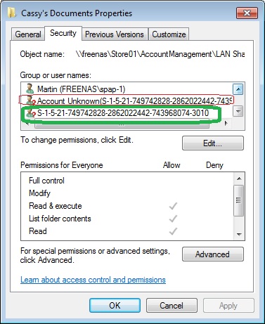

ghostwolf59
Mar 2, 2013
165
hm, Just went into windows and deleted the group account that wrongly were given full access and guess what - Freenas now reports the windows account properly (with the read only permission I initially requested)
HOWEVER, windows no longer lists the group account - so freenas reports the correct user/group and permission, while windows no longer reports the group (see pic)
this is the correct behavior / default permissions for 'windows' permission type. There's a reason things are greyed out. Once you switch to Windows permission type, they are managed through Windows explorer.

"this is the correct behavior..." - perhaps I didn't make myself clear - the issue I have is that the permission changes from what I initially set (check the two images in earlier post) - surely that cant be the correct behavior ? Worked properly with earlier versions.
Another thing I noticed was that once I deleted the account under windows and the proper permissions show up within NAS (but where the desired group no longer exists under window) is that if I decide to update (no actual changes - simply press update within nas) the permission goes back to giving the group full access again (with deadlocks, and unknown accounts reported from windows)

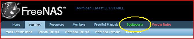

Not sure about the bug report - posted my issues within this forum only to receive a message stating something about me open a bug report account or something - so even though I posted this it appears it will fall onto def ears.

Submit bug reports on the bug report website, not the forums. Developers are basically never on this site.
https://bugs.freenas.org/
