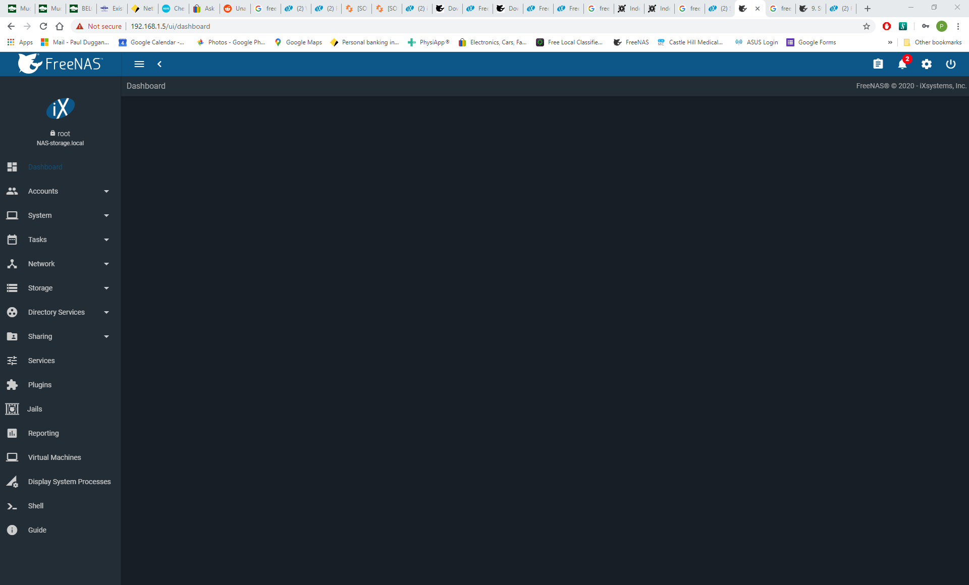

Since updating to 11.3-U3.2 my dashboard now looks like this, all other menus are fine. Any ideas why?
I also still can not connect after boot, I'm wondering if I did the manual update correctly, i used the file "FreeNAS-11.3-U3.2-manual-update.tar"

Hi Samuel, do you have any thoughts as to why my dashboard is completely blank and also after updating my version I still can not connect after a reboot?
Samuel Tai
Apr 24, 2020
5,399
Have you tried clearing your browser cache and history?
Samuel Tai
Apr 24, 2020
5,399
Have you tried running the browser developer tools (F12 in Chrome) to see what's going on under the hood? I vaguely recall something similar to this for someone who's FreeNAS certificate had gotten corrupt.
Assuming something may have been corrupt, I did a clean install of FreeNAS. I imported my Pools, but started clean with the configuration and users and it is now all working correctly, including reconnecting after boot. So something odd must have happened when I did the update.
