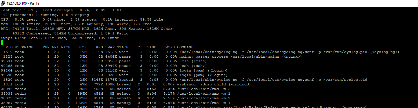

Have a look at htop and see if tautulli is high on the list after using F6 and selecting M_RESIDENT.
Then check top -w then type o then type swap and Enter to see the swap consumers at the top of that list.

Looks like that could be it.... Taut was using around 6Gb memory so does seem like it's leaking.

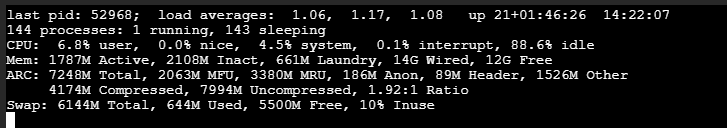

what are your system specs? especially storage and ram. also could you post a screenshot of your ram usage as noted above?

No problem, system is 16TB across 6 WD-Reds with 32GB memory, core i3-6100 running TrueNAS-12.0-U2.1
Swap use has dropped a bit now that I've bounced tautulli
