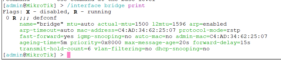

After checking my situation I discovered that in my case, by default, there was no auto-mac, and there was an admin-mac setup already, as you can see in the attachment
