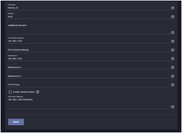

So this is the old values

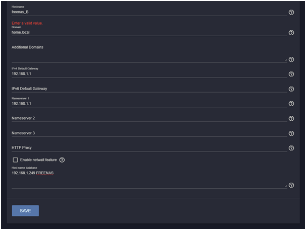

And I need to change the IP from 192.168.1.254 to 192.168.1.1, but this is what I get:

Is it complaining about your host name? What if that’s freenasb without the underscore?

Email alerts are now working, it's found some updates to apply and my cloud sync is working again :smile:
9,700
Well spotted - despite it having that value for ever - removing the underscore appears to have worked
Perhaps the old versions were converting underscores to dashes automatically... DNS names can have dashes, but not underscores.
