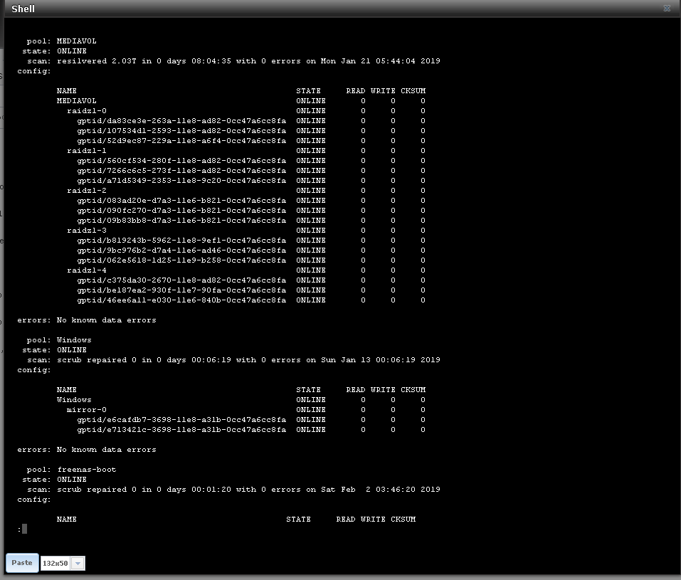

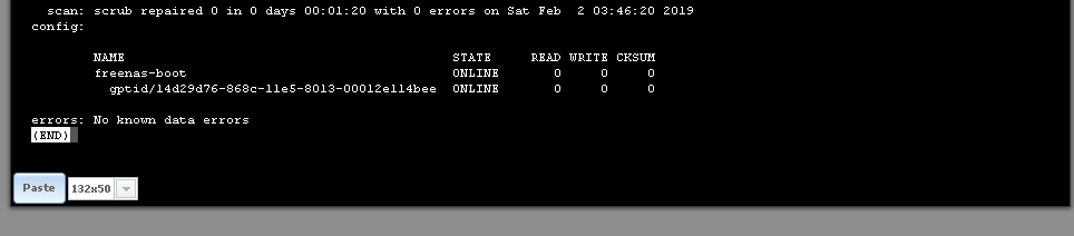

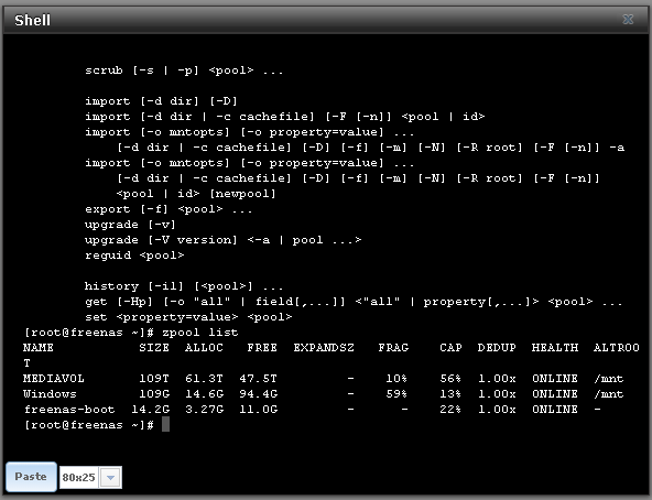

Just an update to say there is no update. Data coming tonight! I did check the pool via the web UI, I'm closing in on 80% space usage which may be contributing to the problem.
southwow
Jan 18, 2018
114
@Chris Moore,
I moved about 10TB of data off onto another server. Still seeing the same slowness. Windows volume is a small SSD mirror for testing Plex performance in a VM so not concerned about the fragmentation.
southwow
Jan 18, 2018
114
Just wanted to add, I also pulled out all of the spares that I had in the 846 chassis that this was in as well. There were 5 of them, that made no difference either.
I'm going to start shopping around for a decent NIC and see if that helps.
LOL, that resliver was the last of the 8tb Seagate drives failing.
