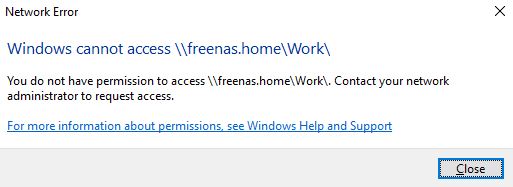

The long story short is that I can see \\freenas.home and I can see all of my shares, but I get a permissions error when I try to open any specific share.

No users have execute on root dataset. This cuts off access for all non-root users. chmod +x /mnt/StorageServer.

No, we don't touch permissions on root-level datasets (middleware explicitly prevented from doing this). Most common scenario I've seen is manual intervention by administrator (i.e. running chmod -x /mnt/<pool>).
