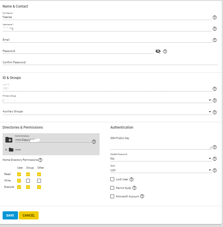

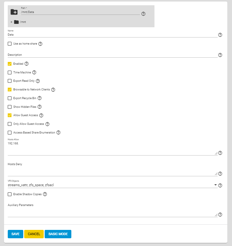

hi, yes i did create an user id , I can use it to login via SSH.
Below are some screenshots, not sure if helps ?
Thanks
9,700
Windows 10 may be denying you connection due to the Allow guest access being checked.
