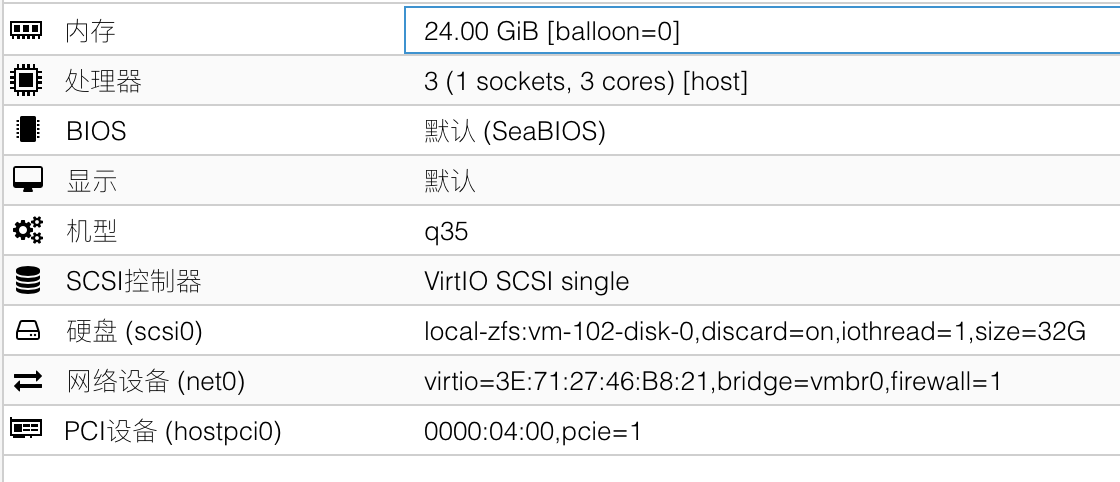

I have one pool , around 30T ,
I need to move /mnt/pool/videos/movies/ files to /mnt/pool/jellyfin/data/movie , but the system will reboot or crash ( hang ) when I just use mv or cp the around 100G files . ( 3 ~ 4 movie folder and files ) .
Is it my hardware perfomance problem ?
FreeBSD truenas.local 13.1-RELEASE-p7 FreeBSD 13.1-RELEASE-p7 n245418-79e75956dbb TRUENAS amd64
trueness core VM on PVE : trueness 's VM conf ( 24G RAM , 3vcpu ( i12100 host ) and "4x16T HC550 raidz1" )
9,700

BensonHo
Oct 10, 2022
9
My PVE hardware : i3-12100 + B660m + 2xM2 1T ( pve system disk) + asmedia m2 to 6 sata card with 16t x 4 + 64g ram
My VM conf . psassthrough asmedia m2 to 6sata card to truenas core and using 16T x4 (raidz1) for the nas pool
9,700
