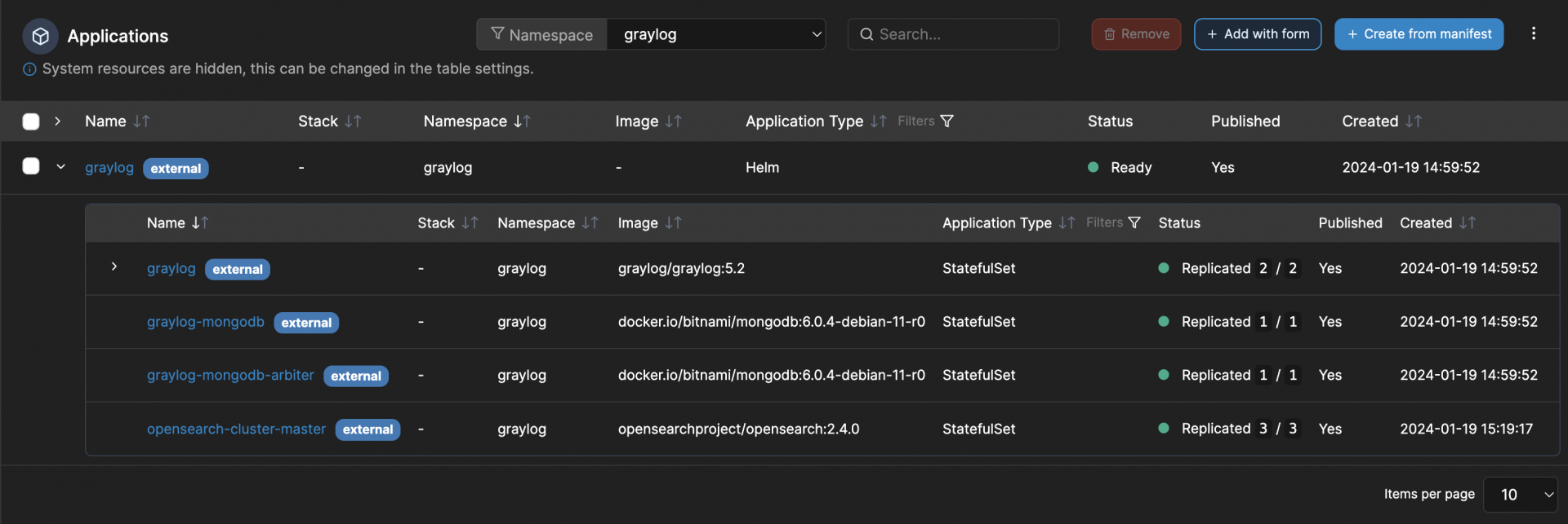

vampirebyte
Nov 28, 2022
20
IIRC, CORE has a plugin (which are bad news in general) for Graylog, but there isn't an app (either from iX or from Truecharts) for SCALE. Not sure why; there's definitely an official Docker image for it.
Probably because there is no good upstream chart for it? Seems like this chart is still managed, tried it and it works very well, deployed a cluster with HelmRepository in fluxcd:

I had a good experience at work with graylog, but with their new licence and original creator leaving the company, not sure what to say.
BTW, I also have grafana, prometheus+operator+traefik+cert-manager+issuer, all from truecharts, working beautifully.
