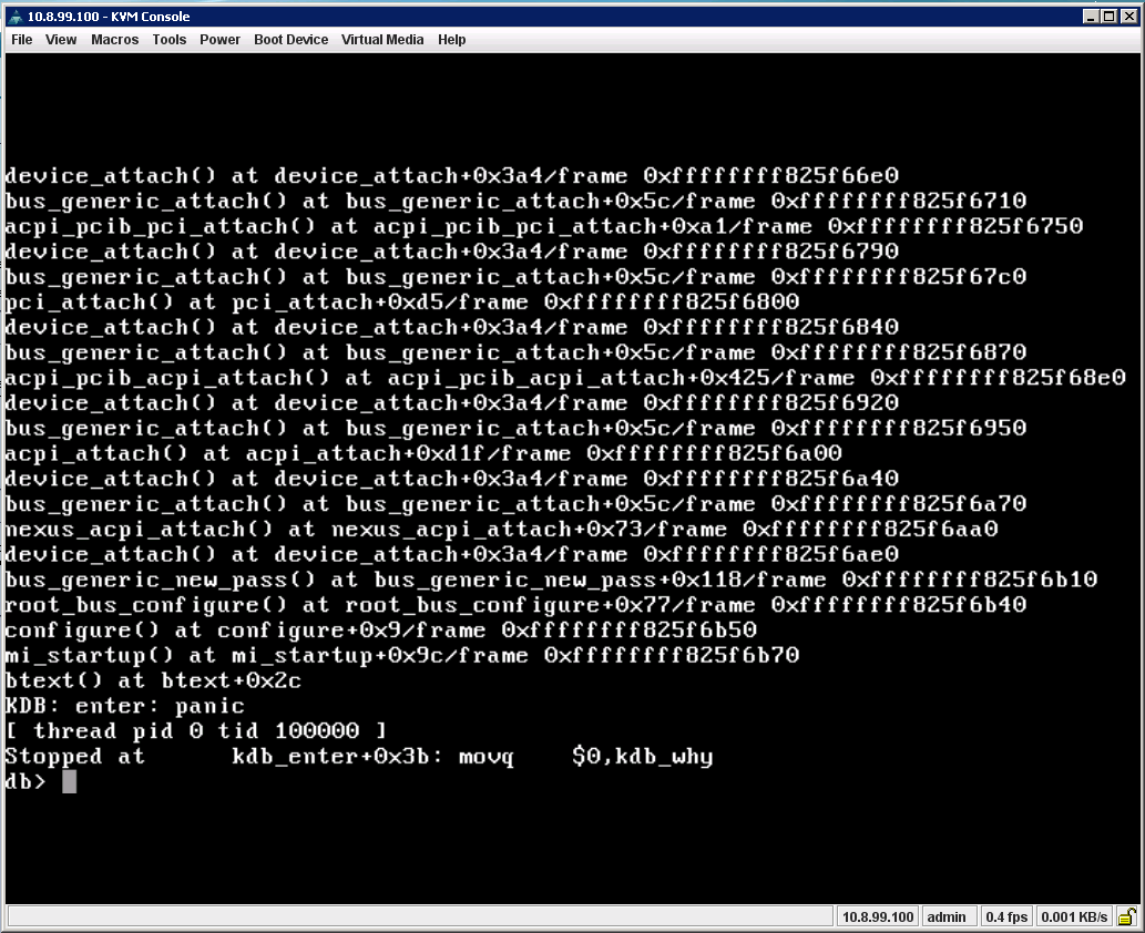

Hello all. I have spent days searching through this forum reading everything that i can and i just cant find my issue. I am booting FreeNAS from a usb, i get 2 options to install FreeNAS, one with and one w/o serial. I choose the option without serial and it starts to load, then no matter what version of FreeNAS 9 or 11 i get this same screen. any help would be great.

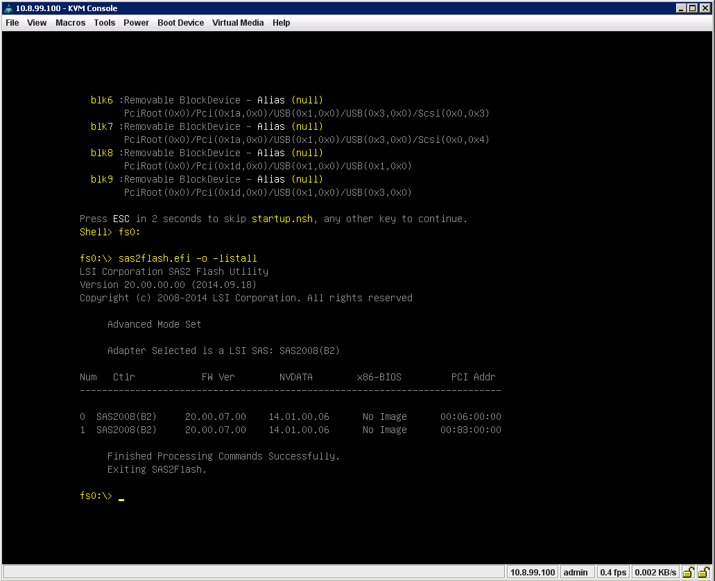

sas2flash --listall output?

I have formatted the sd cards, swapped out the pc riser 2 card, restarted everything and it ended up in the same spot. i will get the sas2flash - listall here in a sec, different usb.

here is a listall screen shot

Your sas2flash looks good with the correct firmware. I was thinking there was a proprietary raid card.
Can you boot a different system using your freenas install? Maybe it's a bad install.
You could also try just removing stuff until it boots. That will tell you the problem piece.

in the Cisco UCS C240 there are riser cards, #1 will run on 1 CPU, #2 only runs when 2nd CPU is present, this one contains the SD cards where i want freenas installed. I downloaded freenas 11 from website and used Rufus to convert the iso to a bootable USB. I get the first prompt were i can choose which freenas to install with or without serial. Then it hangs here everytime. It even did the same thing when i download version 9.

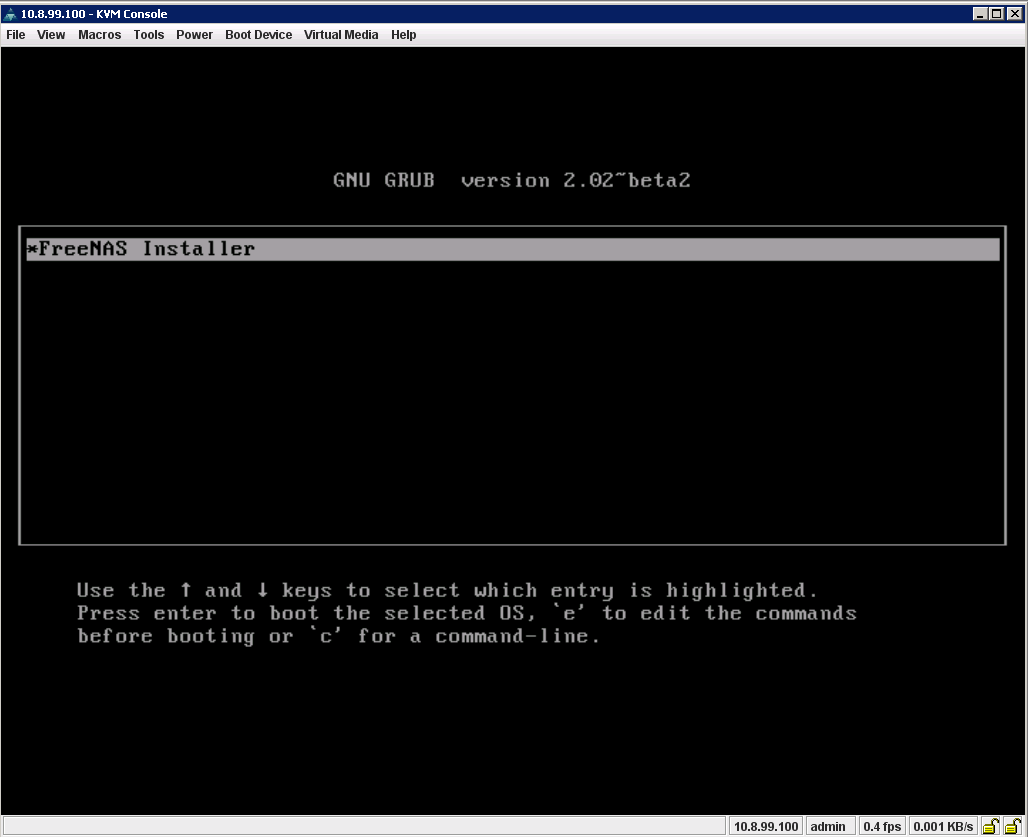

Ok now the serial option isnt available. There used to be a second line here that had (Serial) after it. I dont get the console setup screen, which should be the next step.

That is the normal screen. I wonder if your sd card reader is the problem. Can you try to install from a USB stick?

I actually am trying to load from a USB. I download v11 and used Rufus to write the ISO to bootable USB. Am i doing something wrong here?
