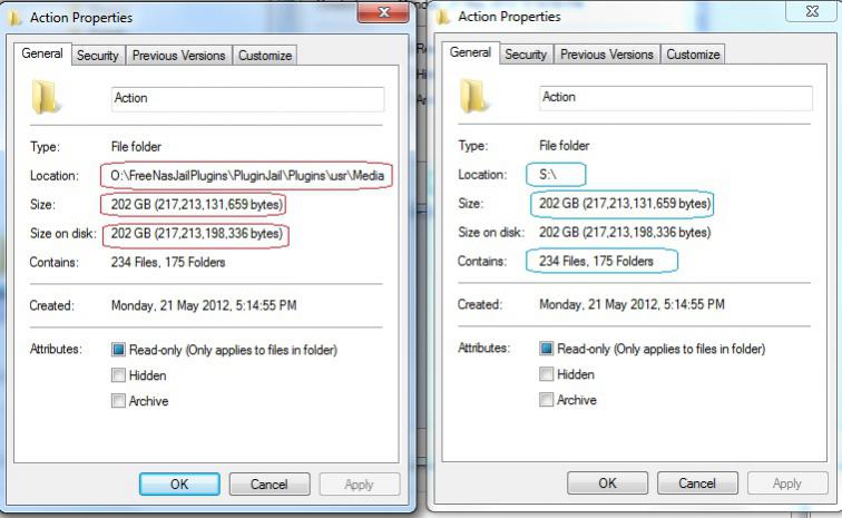

As far as I can see data is duplicated
My S: share is /mnt/STORE03
The Plugin resides on /mnt/STORE01 CIFS share Q
Comparing one of the media folder content on /mnt/STORE03/with /usr/Media/ show that the plugin directory have the same number of files as the source where the size of the plugin content also matches the source.
My STORE01 available space also significantly got less space available
All up the plugin have resulted in a total of 825 GB of duplication.

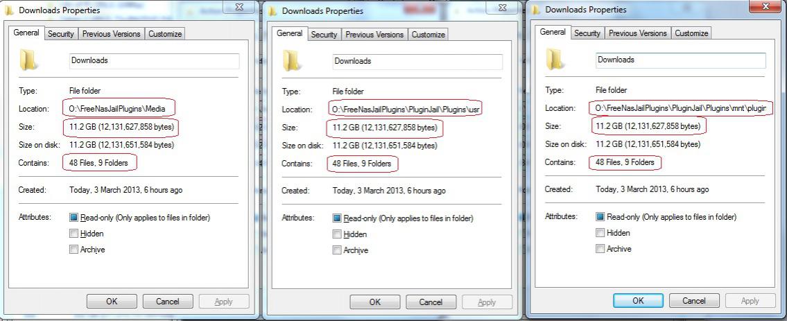

Same thing with the Transmission - The initial allocation from torrents is duplicated across multiple folders
O:\FreeNasJailPlugins\Media\Downloads
O:\FreeNasJailPlugins\PluginJail\Plugins\mnt\plugins\Downloads
O:\FreeNasJailPlugins\PluginJail\Plugins\usr\Downloads
same content and size residing on three different places on disk
- If this isn't duplicating data then I don't know what is :eek:

Why are you using windows to measure your free space? I am new to freenas so keep that in mind. you should think of a mount point as a short cut (or symbolic link if you know what that is) Each one of those folders are pointing to the same files on your hard disk. This does not mean that each folder has duplicated every file. That would be a huge waste of space. What is your available space in the view volumes tab? or you can go to the reporting tab and look at the history of your free space.
Thanks for helping out Caesar, you are 100% correct.
