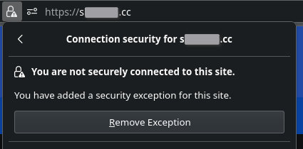

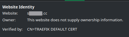

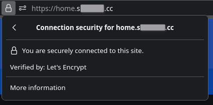

Hello, I'm pretty new to TrueNAS Scale and I'm trying to setup the homer app from truecharts. I have various other apps running and I'm using Traefik to create automatic subdomains for each.
I managed to figure out how to get Traefik to issue certificates with cert-manager (and have them work by setting the TLS encryption mode to Full on cloudflare), but it only works for subdomains and not for the root domain.
Subdomain:
Root domain:
I changed nothing except the HostName in homer's ingress settings.

Reverting back to a TrueNAS Scale certificate instead of cert-manager seems to have worked. Not sure why since I installed cert-manager because the TrueNAS Scale certificate didn't work.
