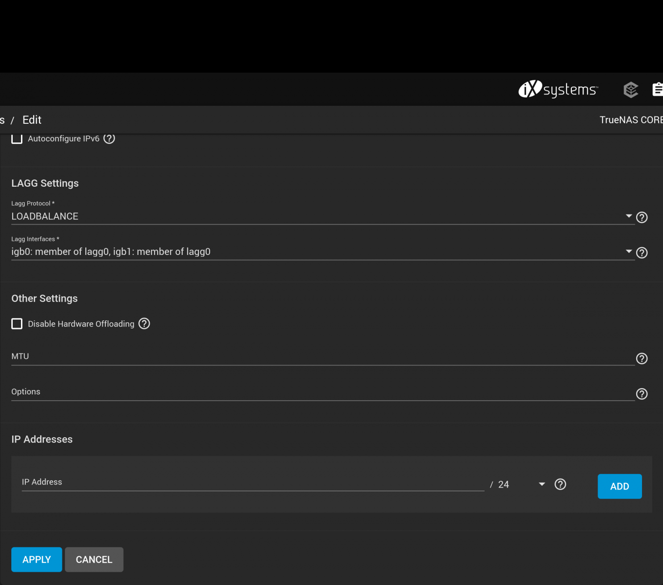

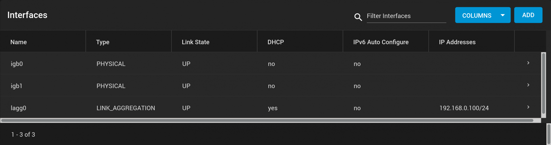

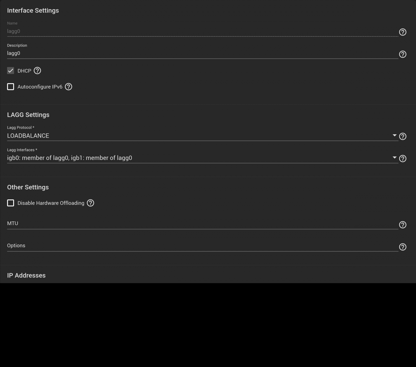

Ok I hear you, but then how do I edit the bridge0 interface when there is no listing in Network / Interface. Also I can't unset the LAGG0 IP through the GUI it won't let me.
You should be able to create it as a new bridge interface.Ok I hear you, but then how do I edit the bridge0 interface when there is no listing in Network / Interface
Can we get a look at how it's showing up and what's preventing you?Also I can't unset the LAGG0 IP through the GUI it won't let me.

nd6 options=1<PERFORMNUD>OK, but I guess you have config in there for the LAGG NIC PORTS?TP-Link TL-SG1016DE and no I don't have impersonation/spoofing or any type of port mirroring going on there.
OK, maybe the IGMP snooping is fine if the LAGG is set up right, but I think it isn't.Yes there are settings for static LAG in the switch but I haven't set it up as I didn't think I needed it or at the time I tried to use LACP and it wouldn't work so I set up TrueNAS with load balance LAGG. IGMP snooping is enabled in the switch yes.
Read that linked post from @Patrick M. Hausen ... maybe it "works" but it's not properly configured if it's like that with an IP on the LAGG.Now I'm wondering if there was any point creating the bridge?
In my 25 years of experience working in this sector of the industry, I have seen plenty of problems caused by the poor configuration of LAGG/Loadbalancing NICs and their attached switching equipment, but I can't really recall any significant positives where it saved us or made a substantive positive impact (almost all the failures where we might have been saved ended up being caused further up the network chain).I'm also wondering if there is any point of even having the LAGG.
