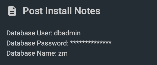

Alright...I updated ZM on two different iocage jails and after updating I ran into this issue...'Unable to connect to ZM db.SQLSTATE[HY000] [1045] Access denied for user 'zmuser'@'localhost' (using password: YES)'. I've spend 8+ hours trying to reset the password, reinstall mysql or the db...doing a lot of stuff that didn't work.
Then, I saw in the logs the zmuser wasn't the right user...it was now trying to use dbuser...that didn't make sense.
I was about to give up and just start over (again!) but then...I found there are post-install notes in the jail. WHY DIDN'T I KNOW THAT? WHY DIDN'T ANYONE MENTION IT!

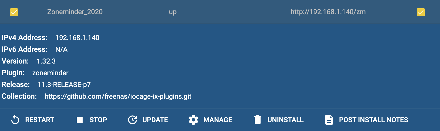

In the jails menu...bottom right corner
Click on 'Post Install Notes' (I replaced password with *s)
Holy sh*t that is what I've been looking for! Why did they change the user and password? I don't know...but whatever, this is what I needed.

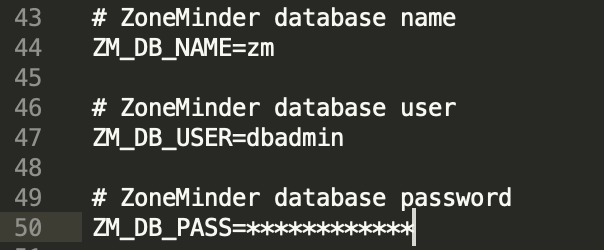

Go to: iocage/jails/Zoneminder_2020/root/usr/local/etc (replace Zoneminder_2020 with your jail name) and edit the zm.conf file...
Replace the user and password with the one in the post install notes.
Restart the jail.
It should work now.
