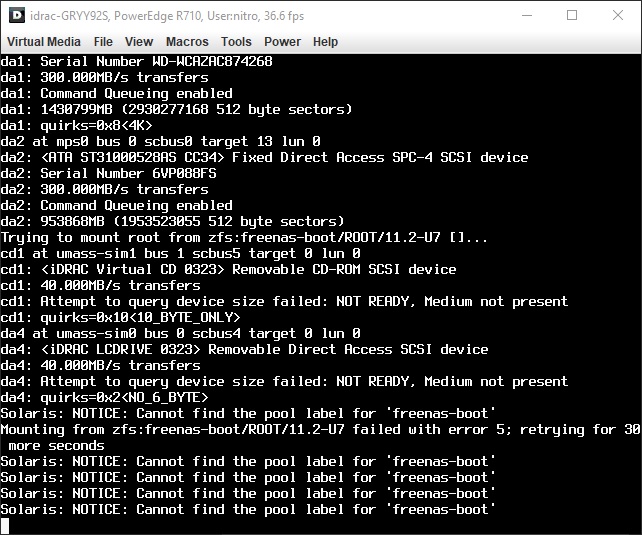

After updating I am getting this, any one else had this?
Dell R710 server spec's in my tag

It's possible the boot device failed. Does a fresh install of that version resolve the issue? If so, you can restore your config.

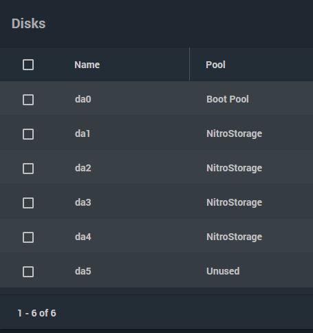

Nah da4 is a pool drive, da0 is the boot SSD, da5 is CDrom

Nitro626
Mar 4, 2019
29
Sure about this? Your post #1 says otherwise. "da4: <iDRAC ... > Removable ...:"
Do you have any virtual media attached via the remote console?
Yes I am sure look at my second post, the update started this error, there is no media in the CDRom or iDarc virtual drive. DA4 is a 1TB pool drive as once I rolled back the update it shows up as shown in post 2 image.

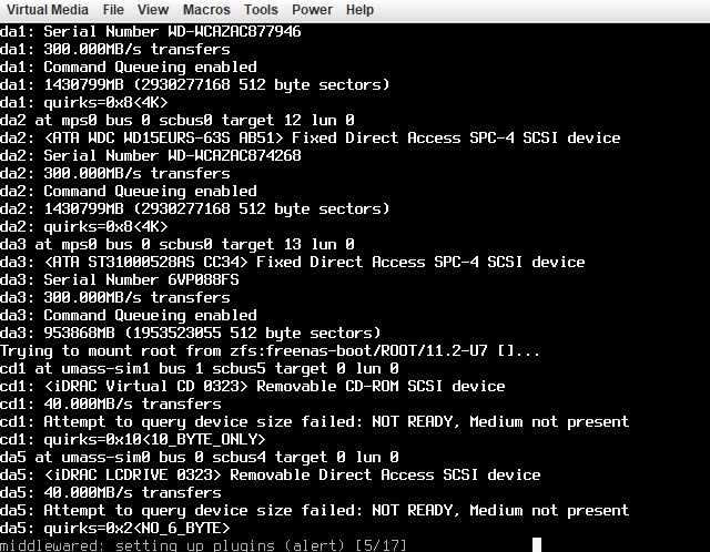

Ok this is odd, I've just re-enable the U7 boot, and its booted ok, but look

Hmm, this really strange, but I still suspect, the boot behaves different as soon as you boot with iDRAC console connected.
Is there anything not working now? Or are you just wondering about the mysterious drives showing up?
So is da4 missing now? What is the output of zpool status?
What is the boot output if you boot without the iDRAC connected?
You can get that output with the dmesg command. When you post it, please don't use images, post text with [code][/code] tags.

atkbd0: [GIANT-LOCKED]
coretemp0: <CPU On-Die Thermal Sensors> on cpu0
est0: <Enhanced SpeedStep Frequency Control> on cpu0
est: CPU supports Enhanced Speedstep, but is not recognized.
est: cpu_vendor GenuineIntel, msr 17
device_attach: est0 attach returned 6
coretemp1: <CPU On-Die Thermal Sensors> on cpu1
est1: <Enhanced SpeedStep Frequency Control> on cpu1
device_attach: est1 attach returned 6
coretemp2: <CPU On-Die Thermal Sensors> on cpu2
est2: <Enhanced SpeedStep Frequency Control> on cpu2
device_attach: est2 attach returned 6
coretemp3: <CPU On-Die Thermal Sensors> on cpu3
est3: <Enhanced SpeedStep Frequency Control> on cpu3
device_attach: est3 attach returned 6
coretemp4: <CPU On-Die Thermal Sensors> on cpu4
est4: <Enhanced SpeedStep Frequency Control> on cpu4
device_attach: est4 attach returned 6
coretemp5: <CPU On-Die Thermal Sensors> on cpu5
est5: <Enhanced SpeedStep Frequency Control> on cpu5
device_attach: est5 attach returned 6
coretemp6: <CPU On-Die Thermal Sensors> on cpu6
est6: <Enhanced SpeedStep Frequency Control> on cpu6
device_attach: est6 attach returned 6
coretemp7: <CPU On-Die Thermal Sensors> on cpu7
est7: <Enhanced SpeedStep Frequency Control> on cpu7
device_attach: est7 attach returned 6
coretemp8: <CPU On-Die Thermal Sensors> on cpu8
est8: <Enhanced SpeedStep Frequency Control> on cpu8
device_attach: est8 attach returned 6
coretemp9: <CPU On-Die Thermal Sensors> on cpu9
est9: <Enhanced SpeedStep Frequency Control> on cpu9
device_attach: est9 attach returned 6
coretemp10: <CPU On-Die Thermal Sensors> on cpu10
est10: <Enhanced SpeedStep Frequency Control> on cpu10
device_attach: est10 attach returned 6
coretemp11: <CPU On-Die Thermal Sensors> on cpu11
est11: <Enhanced SpeedStep Frequency Control> on cpu11
device_attach: est11 attach returned 6
coretemp12: <CPU On-Die Thermal Sensors> on cpu12
est12: <Enhanced SpeedStep Frequency Control> on cpu12
device_attach: est12 attach returned 6
coretemp13: <CPU On-Die Thermal Sensors> on cpu13
est13: <Enhanced SpeedStep Frequency Control> on cpu13
device_attach: est13 attach returned 6
coretemp14: <CPU On-Die Thermal Sensors> on cpu14
est14: <Enhanced SpeedStep Frequency Control> on cpu14
device_attach: est14 attach returned 6
coretemp15: <CPU On-Die Thermal Sensors> on cpu15
est15: <Enhanced SpeedStep Frequency Control> on cpu15
device_attach: est15 attach returned 6
coretemp16: <CPU On-Die Thermal Sensors> on cpu16
est16: <Enhanced SpeedStep Frequency Control> on cpu16
device_attach: est16 attach returned 6
coretemp17: <CPU On-Die Thermal Sensors> on cpu17
est17: <Enhanced SpeedStep Frequency Control> on cpu17
device_attach: est17 attach returned 6
coretemp18: <CPU On-Die Thermal Sensors> on cpu18
est18: <Enhanced SpeedStep Frequency Control> on cpu18
device_attach: est18 attach returned 6
coretemp19: <CPU On-Die Thermal Sensors> on cpu19
est19: <Enhanced SpeedStep Frequency Control> on cpu19
device_attach: est19 attach returned 6
coretemp20: <CPU On-Die Thermal Sensors> on cpu20
est20: <Enhanced SpeedStep Frequency Control> on cpu20
device_attach: est20 attach returned 6
coretemp21: <CPU On-Die Thermal Sensors> on cpu21
est21: <Enhanced SpeedStep Frequency Control> on cpu21
device_attach: est21 attach returned 6
coretemp22: <CPU On-Die Thermal Sensors> on cpu22
est22: <Enhanced SpeedStep Frequency Control> on cpu22
device_attach: est22 attach returned 6
coretemp23: <CPU On-Die Thermal Sensors> on cpu23
est23: <Enhanced SpeedStep Frequency Control> on cpu23
device_attach: est23 attach returned 6
ZFS filesystem version: 5
ZFS storage pool version: features support (5000)
Timecounters tick every 1.000 msec
freenas_sysctl: adding account.
freenas_sysctl: adding directoryservice.
freenas_sysctl: adding middlewared.
freenas_sysctl: adding network.
freenas_sysctl: adding services.
ipfw2 (+ipv6) initialized, divert enabled, nat enabled, default to accept, logging disabled
ipmi0: IPMI device rev. 0, firmware rev. 2.92, version 2.0
ipmi0: Number of channels 5
ipmi0: Attached watchdog
ugen4.1: <Intel UHCI root HUB> at usbus4
ugen2.1: <Intel EHCI root HUB> at usbus2
ugen1.1: <Intel UHCI root HUB> at usbus1
ugen5.1: <Intel EHCI root HUB> at usbus5
ugen0.1: <Intel UHCI root HUB> at usbus0
ugen3.1: <Intel UHCI root HUB> at usbus3
uhub0: <Intel UHCI root HUB, class 9/0, rev 1.00/1.00, addr 1> on usbus4
uhub1: <Intel EHCI root HUB, class 9/0, rev 2.00/1.00, addr 1> on usbus2
uhub2: <Intel UHCI root HUB, class 9/0, rev 1.00/1.00, addr 1> on usbus3
uhub3: <Intel EHCI root HUB, class 9/0, rev 2.00/1.00, addr 1> on usbus5
uhub4: <Intel UHCI root HUB, class 9/0, rev 1.00/1.00, addr 1> on usbus1
uhub5: <Intel UHCI root HUB, class 9/0, rev 1.00/1.00, addr 1> on usbus0
uhub0: 2 ports with 2 removable, self powered
uhub2: 2 ports with 2 removable, self powered
uhub4: 2 ports with 2 removable, self powered
uhub5: 2 ports with 2 removable, self powered
mps0: SAS Address for SATA device = 18202316a28a944e
mps0: SAS Address from SATA device = 18202316a28a944e
mps0: SAS Address for SATA device = 4575414dbba7c696
mps0: SAS Address from SATA device = 4575414dbba7c696
mps0: SAS Address for SATA device = 4575414dbeaec494
mps0: SAS Address from SATA device = 4575414dbeaec494
mps0: SAS Address for SATA device = 7385391e9fa79693
mps0: SAS Address from SATA device = 7385391e9fa79693
mps0: SAS Address for SATA device = 62721065d655b78
mps0: SAS Address from SATA device = 62721065d655b78
uhub1: 4 ports with 4 removable, self powered
uhub3: 4 ports with 4 removable, self powered
ugen2.2: <vendor 0x0424 product 0x2514> at usbus2
uhub6 on uhub1
uhub6: <vendor 0x0424 product 0x2514, class 9/0, rev 2.00/0.00, addr 2> on usbus2
uhub6: MTT enabled
uhub6: 3 ports with 3 removable, self powered
ugen3.2: <Avocent USB Composite Device-0> at usbus3
ukbd0 on uhub2
ukbd0: <Keyboard> on usbus3
kbd2 at ukbd0
ugen5.2: <Avocent USB Composite Device-1> at usbus5
umass0 on uhub3
umass0: <SCSI Transparent Interface 0> on usbus5
umass0:  SCSI over Bulk-Only; quirks = 0x4100
umass0:4:0: Attached to scbus4
umass1 on uhub3
umass1: <SCSI Transparent Interface 1> on usbus5
umass1:  SCSI over Bulk-Only; quirks = 0x4100
umass1:5:1: Attached to scbus5
da0 at mps0 bus 0 scbus0 target 10 lun 0
da0: <ATA OCZ CORE_SSD 0104> Fixed Direct Access SPC-4 SCSI device
da0: Serial Number DC3250000037
da0: 300.000MB/s transfers
da0: Command Queueing enabled
da0: 30560MB (62586880 512 byte sectors)
cd0 at ata2 bus 0 scbus1 target 0 lun 0
cd0: <TSSTcorp DVD+-RW TS-L633J D150> Removable CD-ROM SCSI device
cd0: Serial Number R8B06GMB700293
cd0: 150.000MB/s transfers (SATA 1.x, UDMA5, ATAPI 12bytes, PIO 8192bytes)
cd0: Attempt to query device size failed: NOT READY, Medium not present - tray closed
random: unblocking device.
da4 at mps0 bus 0 scbus0 target 14 lun 0
da4: <ATA WDC WD1003FBYX-0 1V01> Fixed Direct Access SPC-4 SCSI device
da4: Serial Number WD-WCAW31600347
da4: 300.000MB/s transfers
da4: Command Queueing enabled
da4: 953868MB (1953523055 512 byte sectors)
da2 at mps0 bus 0 scbus0 target 12 lun 0
da2: <ATA WDC WD15EURS-63S AB51> Fixed Direct Access SPC-4 SCSI device
da2: Serial Number WD-WCAZAC874268
da2: 300.000MB/s transfers
da2: Command Queueing enabled
da2: 1430799MB (2930277168 512 byte sectors)
da2: quirks=0x8<4K>
da1 at mps0 bus 0 scbus0 target 11 lun 0
da1: <ATA WDC WD15EURS-63S AB51> Fixed Direct Access SPC-4 SCSI device
da1: Serial Number WD-WCAZAC877946
da1: 300.000MB/s transfers
da1: Command Queueing enabled
da1: 1430799MB (2930277168 512 byte sectors)
da1: quirks=0x8<4K>
da3 at mps0 bus 0 scbus0 target 13 lun 0
da3: <ATA ST31000528AS CC34> Fixed Direct Access SPC-4 SCSI device
da3: Serial Number 6VP088FS
da3: 300.000MB/s transfers
da3: Command Queueing enabled
da3: 953868MB (1953523055 512 byte sectors)
Trying to mount root from zfs:freenas-boot/ROOT/11.2-U7 []...
cd1 at umass-sim1 bus 1 scbus5 target 0 lun 0
cd1: <iDRAC Virtual CD 0323> Removable CD-ROM SCSI device
cd1: 40.000MB/s transfers
cd1: Attempt to query device size failed: NOT READY, Medium not present
cd1: quirks=0x10<10_BYTE_ONLY>
da5 at umass-sim0 bus 0 scbus4 target 0 lun 0
da5: <iDRAC LCDRIVE 0323> Removable Direct Access SCSI device
da5: 40.000MB/s transfers
da5: Attempt to query device size failed: NOT READY, Medium not present
da5: quirks=0x2<NO_6_BYTE>
GEOM_MIRROR: Device mirror/swap0 launched (2/2).
GEOM_MIRROR: Device mirror/swap1 launched (2/2).
GEOM_ELI: Device mirror/swap0.eli created.
GEOM_ELI: Encryption: AES-XTS 128
GEOM_ELI:     Crypto: hardware
GEOM_ELI: Device mirror/swap1.eli created.
hwpmc: SOFT/16/64/0x67<INT,USR,SYS,REA,WRI> TSC/1/64/0x20<REA> IAP/4/48/0x3ff<INT,USR,SYS,EDG,THR,REA,WRI,INV,QUA,PRC> IAF/3/48/0x67<INT,USR,SYS,REA,WRI> UCP/8/48/0x3f8<EDG,THR,REA,WRI,INV,QUA,PRC> UCF/1/48/0x60<REA,WRI>
lagg0: link state changed to DOWN
ums0 on uhub2
ums0: <Mouse> on usbus3
ums0: 3 buttons and [Z] coordinates ID=0
bce0: link state changed to UP
lagg0: link state changed to UP
bce1: Gigabit link up!
bce1: link state changed to UP
bce0: Gigabit link up!
bridge0: Ethernet address: 02:a9:90:b3:aa:00
epair0a: Ethernet address: 02:c8:10:00:06:0a
epair0b: Ethernet address: 02:c8:10:00:07:0b
epair0a: link state changed to UP
epair0b: link state changed to UP
epair0a: changing name to 'vnet0:1'
bce0: promiscuous mode enabled
bce1: promiscuous mode enabled
lagg0: promiscuous mode enabled
bridge0: link state changed to UP
vnet0:1: promiscuous mode enabled
epair1a: Ethernet address: 02:c8:10:00:07:0a
epair1b: Ethernet address: 02:c8:10:00:08:0b
epair1a: link state changed to UP
epair1b: link state changed to UP
epair1a: changing name to 'vnet0:2'
epair1b: changing name to 'epair0b'
vnet0:2: promiscuous mode enabled
epair2a: Ethernet address: 02:c8:10:00:08:0a
epair2b: Ethernet address: 02:c8:10:00:09:0b
epair2a: link state changed to UP
epair2b: link state changed to UP
epair2a: changing name to 'vnet0:3'
epair2b: changing name to 'epair0b'
vnet0:3: promiscuous mode enabled
epair3a: Ethernet address: 02:c8:10:00:09:0a
epair3b: Ethernet address: 02:c8:10:00:0a:0b
epair3a: link state changed to UP
epair3b: link state changed to UP
epair3a: changing name to 'vnet0:4'
epair3b: changing name to 'epair0b'
vnet0:4: promiscuous mode enabled
epair4a: Ethernet address: 02:c8:10:00:0a:0a
epair4b: Ethernet address: 02:c8:10:00:0b:0b
epair4a: link state changed to UP
epair4b: link state changed to UP
epair4a: changing name to 'vnet0:5'
epair4b: changing name to 'epair0b'
vnet0:5: promiscuous mode enabled
epair5a: Ethernet address: 02:c8:10:00:0b:0a
epair5b: Ethernet address: 02:c8:10:00:0c:0b
epair5a: link state changed to UP
epair5b: link state changed to UP

Hmm, apart from the iDRAC it looks pretty normal now. Do you still have problems?
Nitro626
Mar 4, 2019
29
Yeah the U7 boot still sometime errors with the wrong drive, I am going to try a clean install when I get 30 minutes LOL as suggested by dlavigne
