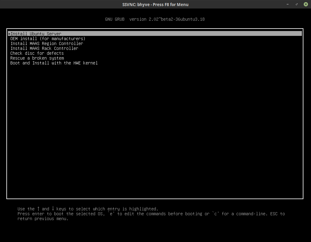

This is the screen I get when no Ubuntu is installed in the beginning, and also directly after snapshotting.

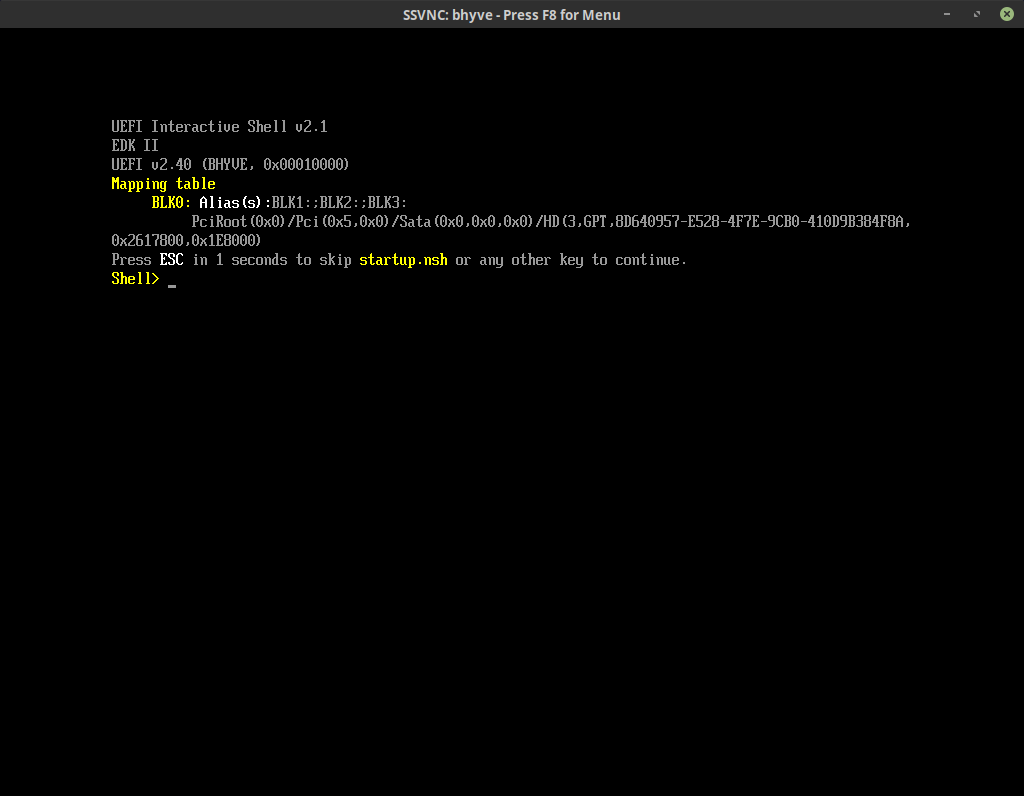

If I empty the VM-cdrom (leave the ISO-field blank in CD-ROM settings) I get this screen.
