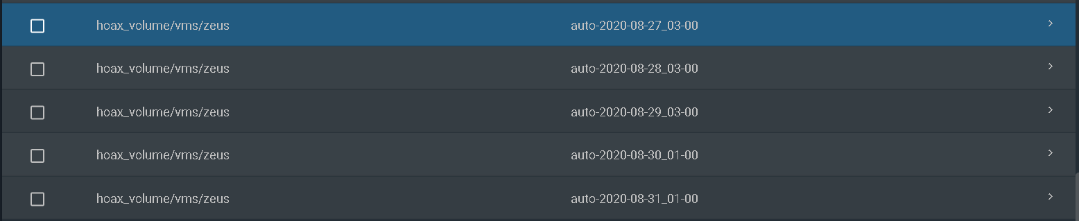

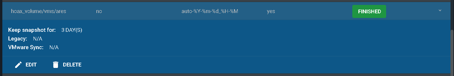

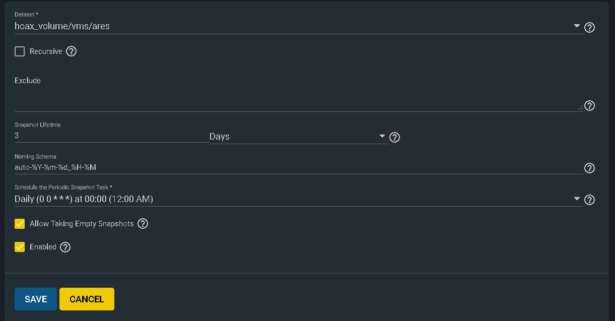

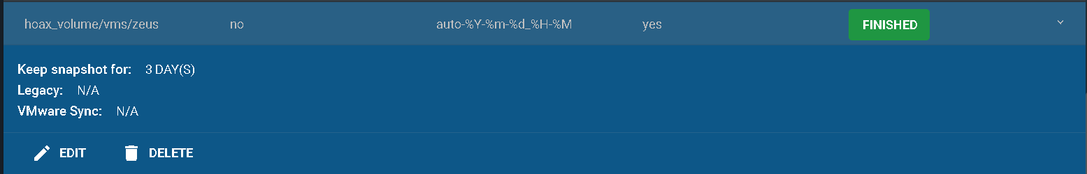

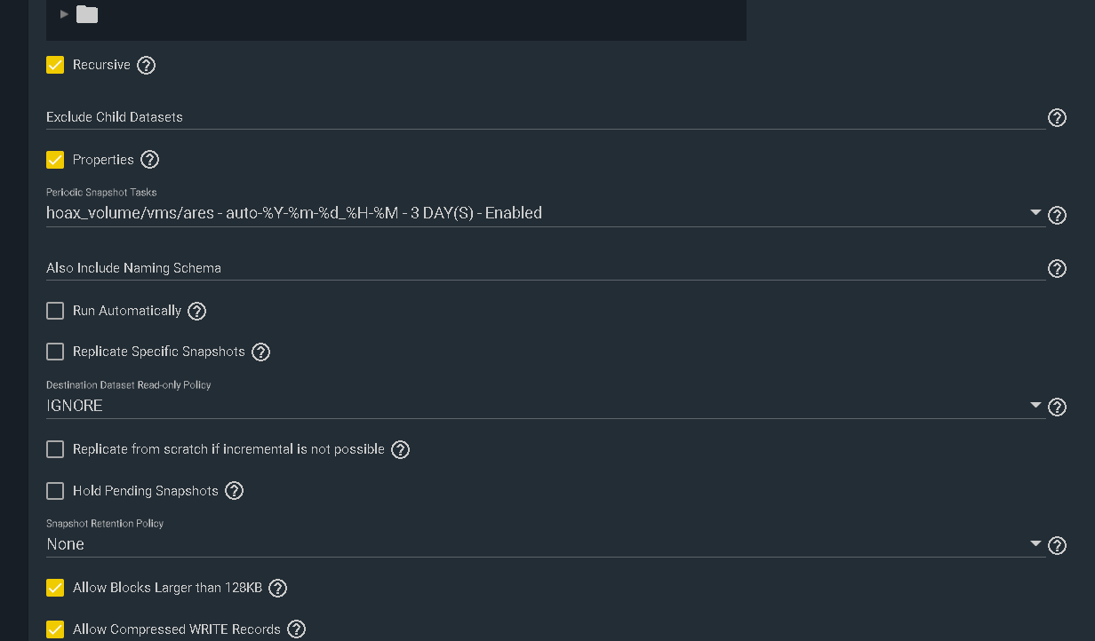

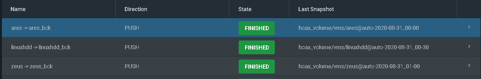

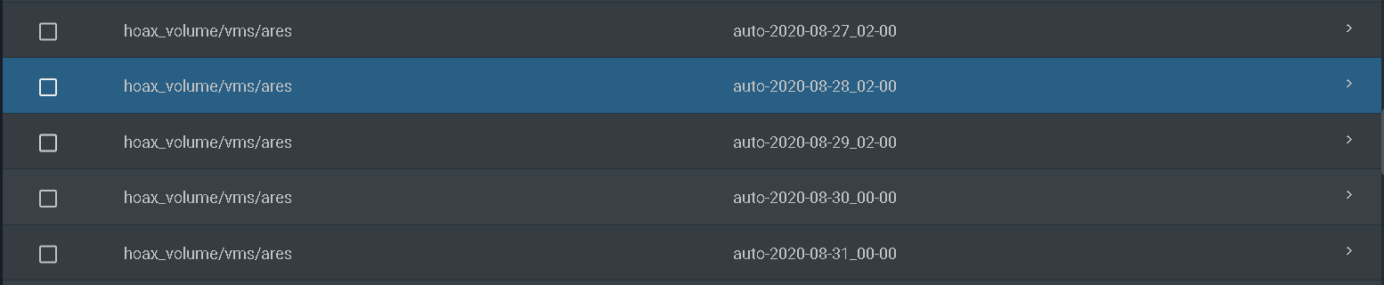

Greetings,
i read everything in the forum and still have questions.
I have Freenas FreeNAS-11.3-U4.1
32GB RAM
6x4TB HDD RAIDZ2
I have dataset with 3 zvol's
Snapshots (daily) on same pool with replication to another pool
I am trying to make the snapshot disapear after 3 days, but it doesnt work.
Please advise why it is not deleting after the lifetime.
P.S. i have deleted some manualy so you will see 3 or 5 files
Thank you

ukro
Mar 6, 2020
10
Sorry i didnt put one more screenshot,that was for P.S. i have deleted some manualy so you will see 3 or 5 files .
But i think it is not necessary.

Thank you, will keep track on that. But its a bit different as i didn't put automatic run. Everyting is doing by time. And i know that snapshot is already done and after only that im making replication. And i dont have hold pending snapshots
ukro
Mar 6, 2020
10
Interesting,that when i turn off replication which is set on the truenas, then on freenas the snapshots apears to be okay and delting by the lifetime.
So my thoughts are that you need to setup replication with snapshots only on one side. Because i had setup that one will make snapshots and the second side will pull the dataset with snapshots.
