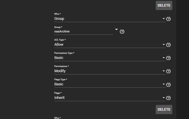

I gave the nasArchive group the SMB rights from GUI like this

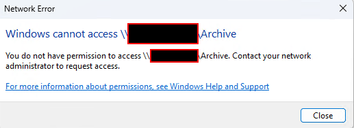

But when I login to the NAS with the veeam user i receive

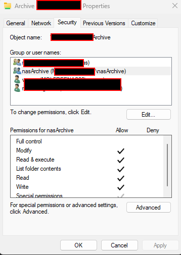

ACL are correctly configured

Your user need execute permissions via some ACL entry for every parent path of the share.
Ok, but how I set that?
Do I need to change directly on the shell the rights for "others" and set something like --x or r-x ?
This is the current configuration

I also run this command
root@NAS:/ # getfacl /mnt/Pool/Samba/DataArchive/
# file: /mnt/Pool/Samba/DataArchive/
# owner: ABC
# group: nas
group:nas:rwxpDdaARWcCos:fd-----:allow
user:ABC:rwxpDdaARWcCos:fd-----:allow
group:nasArchive:rwxpDdaARWc--s:fd-----:allow
user:veeam:rwxpDdaARWc--s:fd-----:allow
everyone@:--------------:fd-----:allow
I can add more details taken from logs

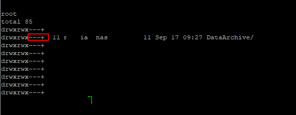

You should also look at ACL on /mnt/Pool/ and /mnt/Pool/Samba/
I don't get this point.
I'm exporting the smb share the /mnt/Pool/Samba/DataArchive dataset.
The upper dataset isn't exported nor configured for SMB access.
I don't know if I'm missing something but I don't think that this matters, Am I wrong?
Yes, this is how POSIX-compliant filesystems work. There is strict traverse checking. The execute bit does similar in Windows, but interactive sessions typically have a privilege that allows bypassing traverse checking. So Linux, FreeBSD, MacOS, and Windows to some extent all do this.
