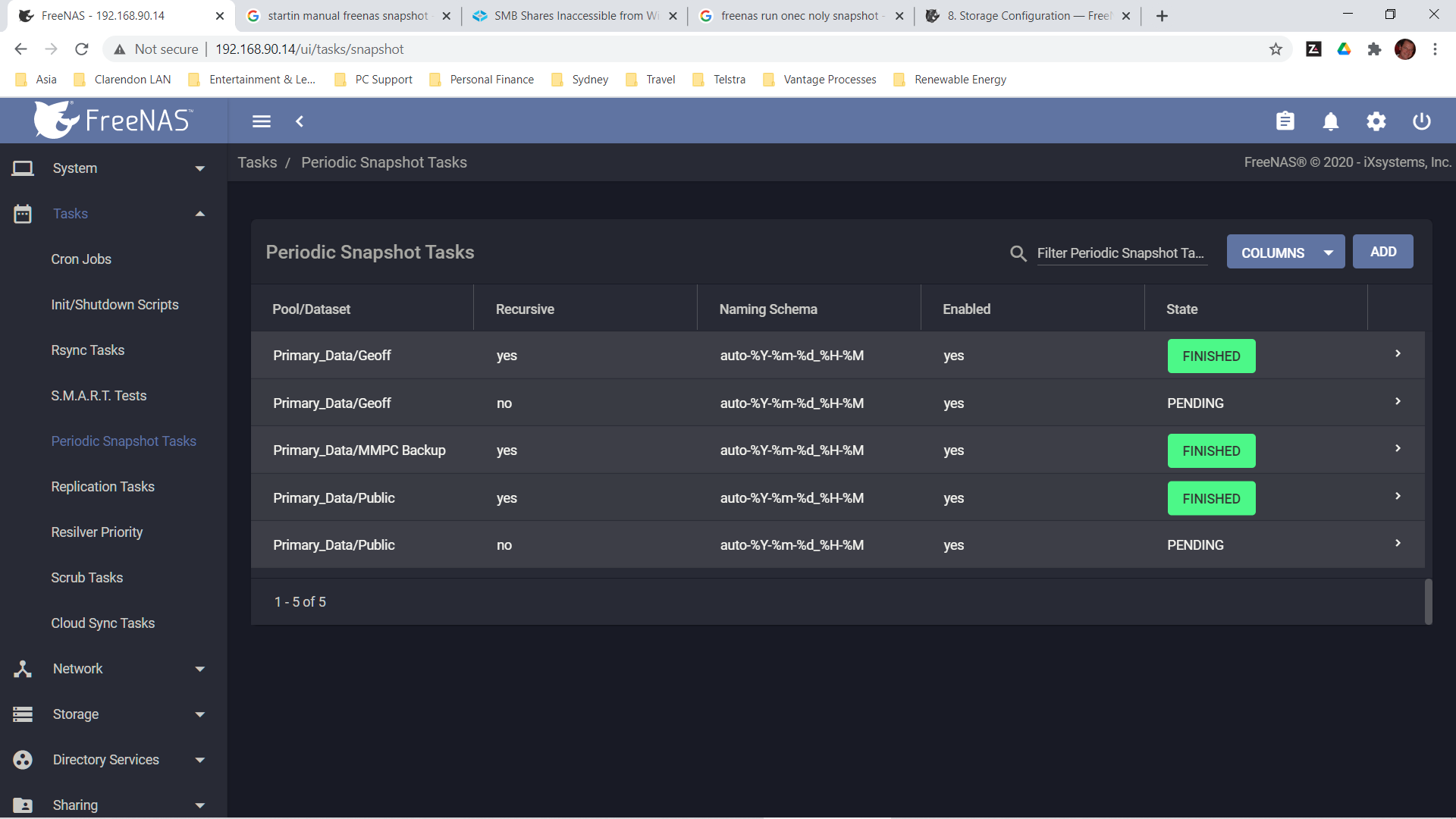

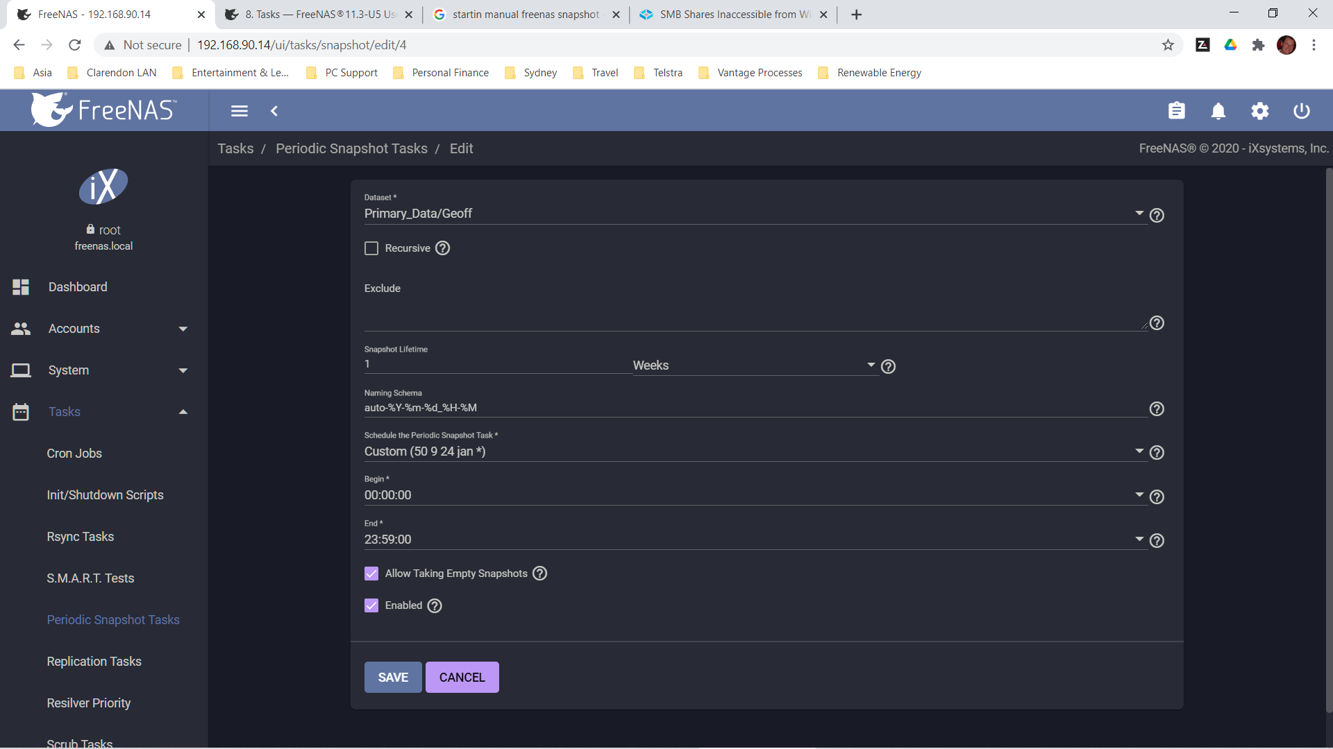

The Manual is not very clear on setting up a 'one off' snapshot. I hope this is a correct interpretation (ditto for Public):
geoffwhere
Apr 23, 2020
105
Well, that didn't work so I'm still in the dark about how to run a one-off snapshot. The above snapshot (and its twin for the Public dataset are sitting there with status 'Pending'.

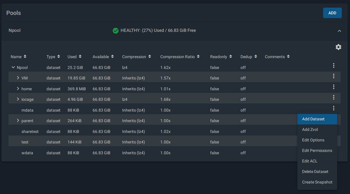

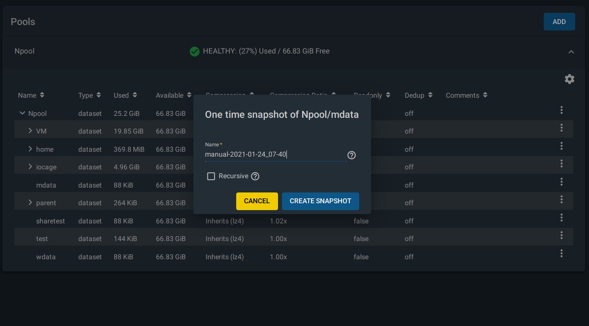

You are taking a snapshot as a precuationary measure only in this case, a "point in time copy" you can rollback to if something goes wrong when you change the dataset ACL, etc. It's a "one off" manual snapshot which you can create as per example below. It's not done via a periodic task and if the ACL change is successful you can immediately delete this manual snapshot. ( If you have a schedule of periodic snapshots already set up on the same dataset, do these ACL changes in the interval between the timed snapshots)
Go to "Storage/Pool" and select the three dots to right of line with the named dataset and then select "create snapshot". For example:
