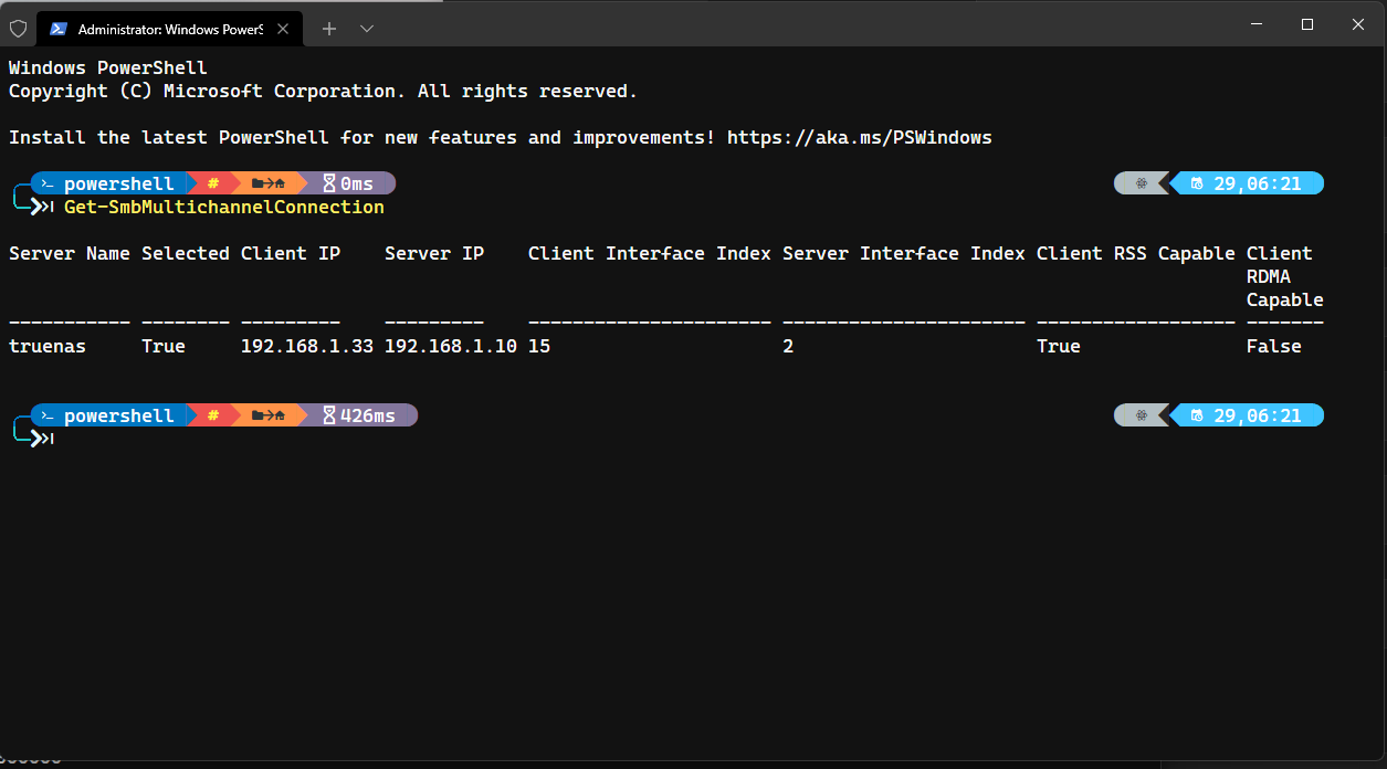

im.thatoneguy
Nov 4, 2022
37
Actually it looks like RSS capability is automatically enabled. I added multichannel to the smb extended args and Windows detected TrueNas immediately as RSS capable and opened 4 threads.

Sawtaytoes
Jul 9, 2022
221
You can generally verify via powershell. The SMB server advertises it's RSS-capable if the NIC provides this info (there's auto-detection code in Samba for this capability). Hardware being vendors such as they are, I would suspect there are some outliers where things are marketed as such but somewhat inconsistent with what they report to the kernel.
What PowerShell command can I use to see RSS capabilities of my NIC with SMB?

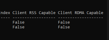

Sawtaytoes
Jul 9, 2022
221
After running `Get-SmbMultichannelConnection` in an Admin PowerShell session, I got `False` for RSS.
It seems RSS isn't enabled.
What's the API for enabling multichannel?
