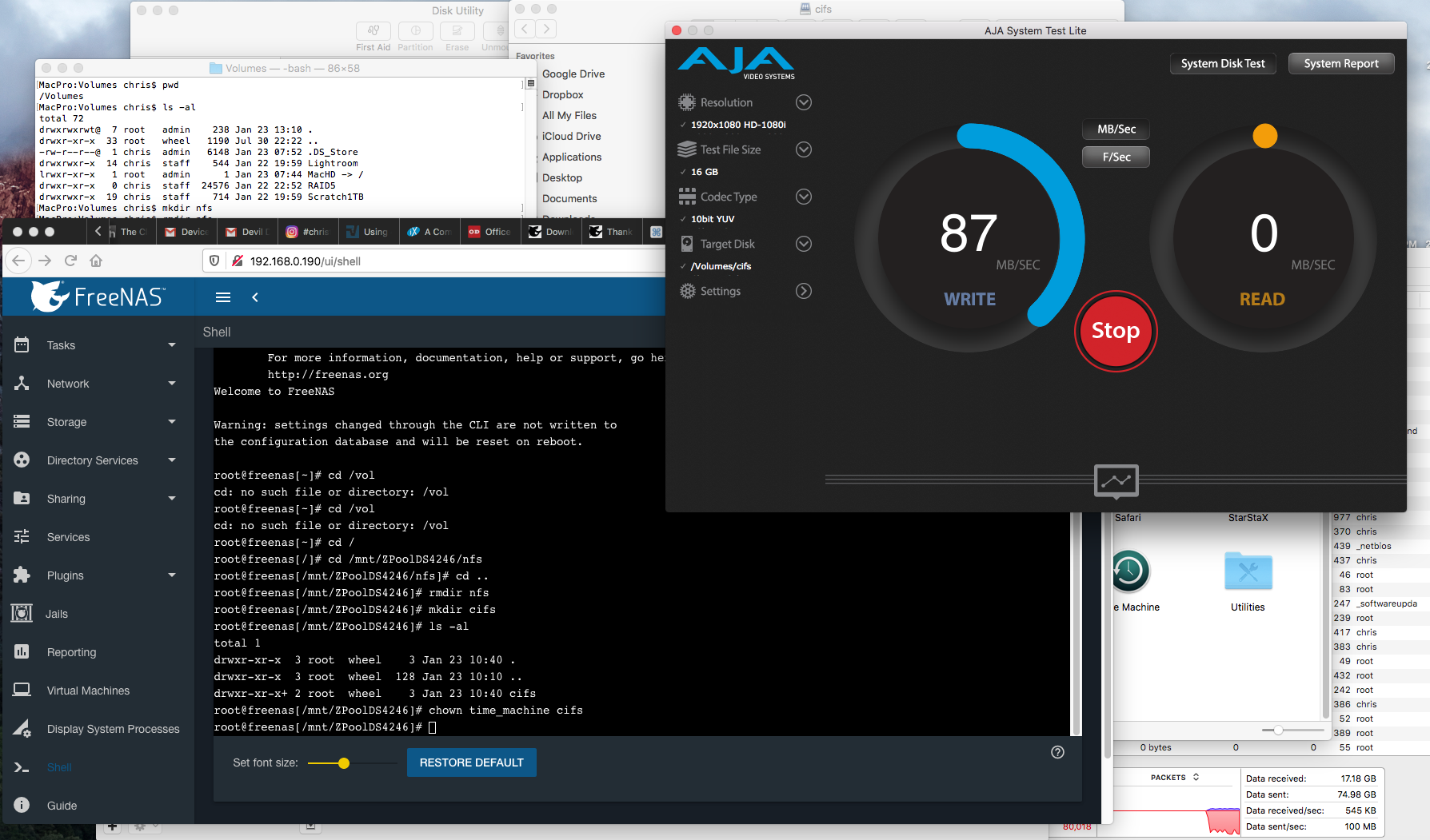

Here's a screenshot, it's the same performance, so I just aborted the AJA test.

The performance problems I was seeing when I posted initially was with iSCSI, but iSCSI and SMB both appear to exhibit the same performance problems. The infrastructure is sound, because I can hit an HGST SAS SSD ZVol at 400+MB/sec on reads and writes, and the Z3 can sustain 300+MB/sec on reads and writes from a Dell box, so there's a combination of macOS and FreeNAS that isn't working. It could still be a write caching issue, but I don't know enough about macOS' write caching configuration to know how to adjust it.

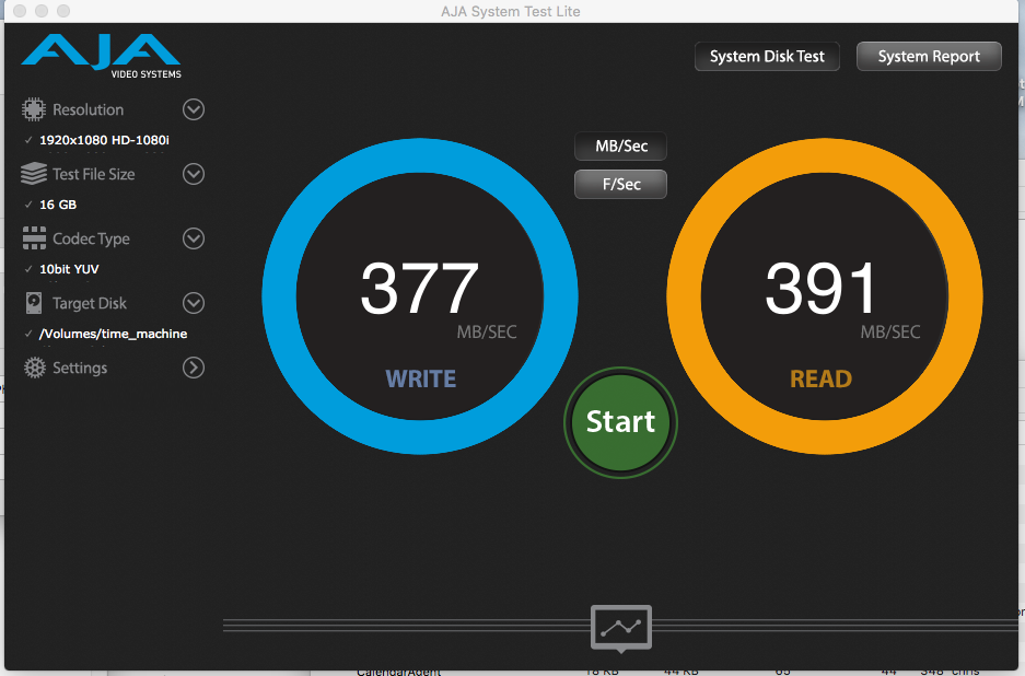

Looks like the magic is AFP with a file extent. Everything else was unusably slow.
Chris
