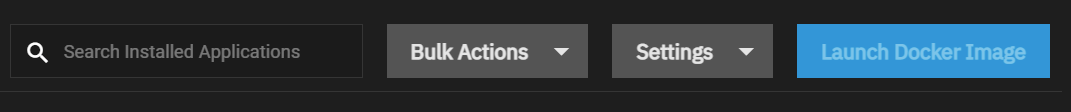

Just upgraded to the new version 22.02.2
  • Now I cannot "Launch Docker Image" anymore. The button is not active.
  • Settings sub menus are not active either.
Anybody seeing the same ?

I have been waiting since my first post a 8:12 AM but still not able to Launch Docker Image in Applications.
Also, the sub menus to the Settings menu are inactive.
I have now tried to roll back to 22.02.1 and everything is working fine. Then updated to 22.02.2 again and the error is back.

Can you open a shell and run "systemctl status k3s" ? Sounds like kubernetes didn't start. I'd recommend going to Settings -> Unset Pool, and then Settings -> Set Pool again to see if a fresh init of k3s fixes it.

Actually scratch that, looks like I have a repro case here. Will file a ticket and investigate.

Also, found out the "Launch Docker Image" button works fine if you go to the "Available Applications Tab" first, but we'll get it fixed either way.

Remember that it also the sub menus to the Settings menu are inactive.

Yep, those sub-menus also work on that tab, so we think its same bug hitting them all. We'll get a fix soon.

I am having the same issue above - The Launch Docker Image is grayed out and I cannot click it.
The menu items under settings are not working - Choose Pool / Advanced Settings / Unset Pool.
