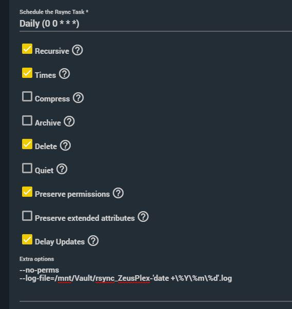

If it's an SMB share, it's probably related to the aclmode on the dataset. Try to rsync with the --no-perms option.

Ok i'll try that. It is a smb share. This is what you meant by that right.
