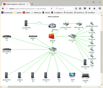

I use: https://www.pfsense.org/
and do all the above on my home network:
