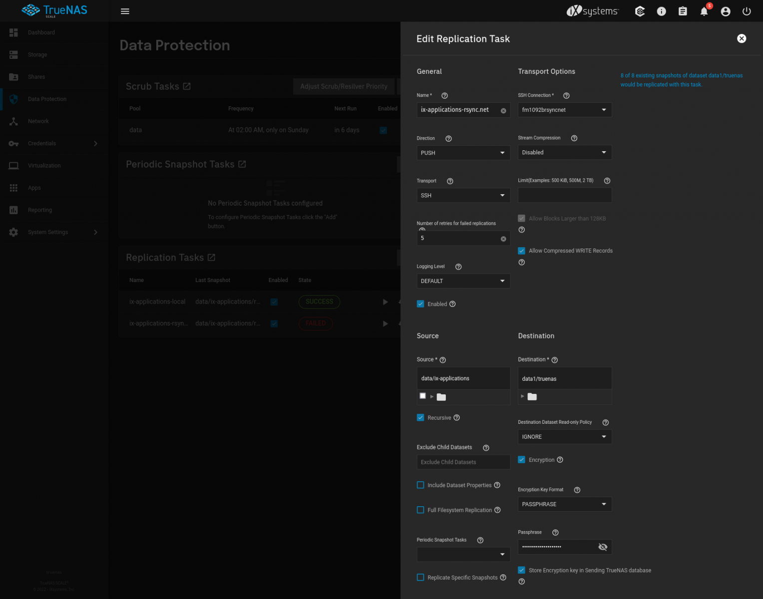

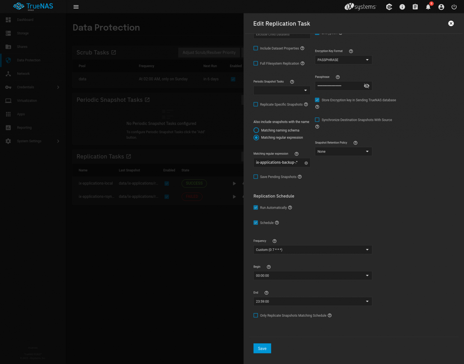

I set up a couple replication tasks, both remote to rsync.net and local to another dataset, using this guide by TrueCharts. My replication was randomly, and is now constantly, giving an error similar to the one below (the long hash changes). This happens for both local and remote.
Here's what I got out of the log:
Here's the configuration for the remote rsync.net job:
I've been struggling with this for months, and even replaced the SATA cables since I was told that could be a potential cause of weirdness, but to no avail. Any help is much appreciated.
Thank you!
TrueNAS version: TrueNAS-SCALE-22.02.1

zettarepl.transport.zfscli.exception.DatasetDoesNotExistException: cannot open 'data/ix-applications/docker/024190454f7c7bc675ba126f3865aa933fbe2c2a201501712f05ff39e5d5c734': dataset does not existHere's the configuration for the remote rsync.net job:
