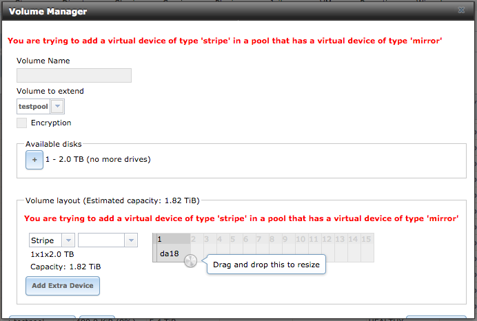

You can't. You added it as a separate striped disk to your pool, blowing through a warning screen with bold red text, and switching into manual mode, in order to do so. Back up your data, destroy your pool, and recreate it with the correct disks. And next time check the manual's instructions on replacing disks.
15,504
What part of this screen:
made you think, "sure, I should switch to Manual Setup so I can bypass this"?
