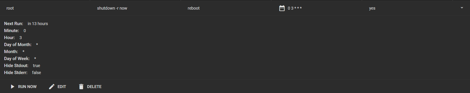

Hi, this could be some sort of newbie question, but I have no idea why it did not work.
I've set up a reboot script for my truenas, as you can see it should reboot my machine every day at 3:00 am:

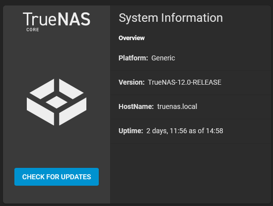

when I first set it, everything's working fine, but sometimes it fails, and for days it won't reboot until I do it manually.
What's more, if I click the 'RUN NOW' in webUI, which should run the script, my truenas does not reboot; while if I type `reboot now` in the Terminal, it does.
I guess there might be some process stuck? This is not quite critical but rather annoying, would be glad if someone could help me out. Thanks in advance!

You see that you typed "shutdown" not reboot, right?

You appear to be giving evidence that there's a different way that works... why aren't you using it?
Sorry for the misunderstanding, actually I tried `shutdown -r now` in the terminal and it worked. So I do not think it should be a problem of the `shutdown` or `reboot` command.

Typically, this is a path error. For cron jobs, it's good practice to specify the full path of the command: /sbin/reboot or /sbin/shutdown.
