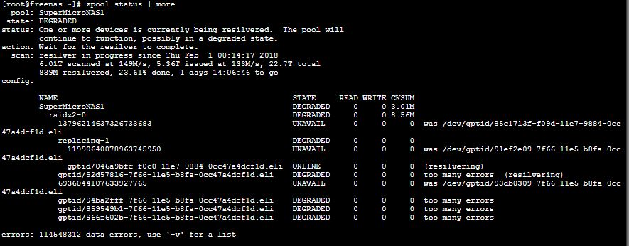

Hey everyone,
at first, here my FreeNAS Configuration:
- RaidZ2, encrypted
- 7 4TB HDD (Seagate Desktop), to be replaced by 7 8TB IronWolf (Standard, not Pro)
- Supermicro X9SCL-F
- Xeon E3 1220V2
- IBM M1015 Raid-Controller, flashed for IT Mode
- 32GB ECC Ram
- FreeNAS-11.1-U1
Now the problem:
I wanted to increase the size of my RAIDZ2 Dataset, by changing drive by drive by a bigger one.
For this reason, i followed the guideline in the FreeNAS Documentation, unfortunately (my silliness), i thought i have no time and a RaidZ2 Configuration, I set 2 4TB drives offline and replace them by the Seagate IronWolf 8TB.
Everything so far went fine and it was resilvering already for about 4 Days to ~80%. Then, without any warning, FreeNAS rebooted and i had to start the resilvering process again (it started around 40% progress, for whatever reason) and at ~ 55% FreeNAS crashed again and rebooted.
Consequently resilvering started again by itself, but this time at 0%. The first 20% were very fast (around 4 hours), the next 5% already now needed 8 Hours. CPU is almost idle, same for the HDDs.
What is best way, to solve this problem? Can I get somewhere logs, where I will find, why it crashed and why it becomes so slow?
Is it smart, to remove one of the 2 8TB Seagate Drives, to resilver at first only one pool?
On the screenshot is the zpool status to see, with its current progress. Until now I had NEVER a problem with any of the HDDs, as well as with unstable FreeNAS System (everything worked always perfectly fine).
Thanks already for your help.

Well, more than 114 millions data errors (never saw that many errors until now...), this pool is dead, I hope you have a backup.
Sounds like multiple drives are starting to die or maybe the PSU is dying or not enough.
Can you post the output (between code tags) of smartctl -a /dev/daX (X being the device number) for all your drives please?
As you've probably already figured out it wasn't a good idea to replace two disks at the same time because any error in the other disks would mean loss of data as no redundancy was here to correct them. @All whatever your RAID-Z level is, keep at least one disk of redundancy when you do that, even if it means it'll take more time to expand the pool.

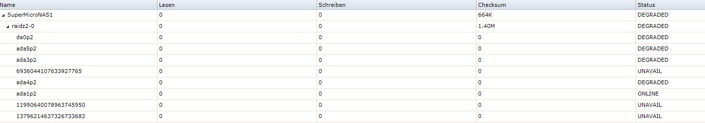

Gen8 Runner
Aug 5, 2015
103
I would try reducing the power load by removing the other pool. That is much less risky.
I did so. Remove the second Dataset from the computer, to ensure, that the HDD's get enough power.
But it's weird, something seems to be here completely wrong:
- HDD after HDD get's degraded
- Freenas shows now, that the pool consists of 8 HDD's. But that pool never consisted of 8 HDD's (they're even physically not connected, for this reason it is impossible)
I now also connected all the HDD's to the Onboard-SATA Controller (6 of 7, have only 6 connectors on the Mainboard), to ensure, that the IBM Controller is not part of the problem.
