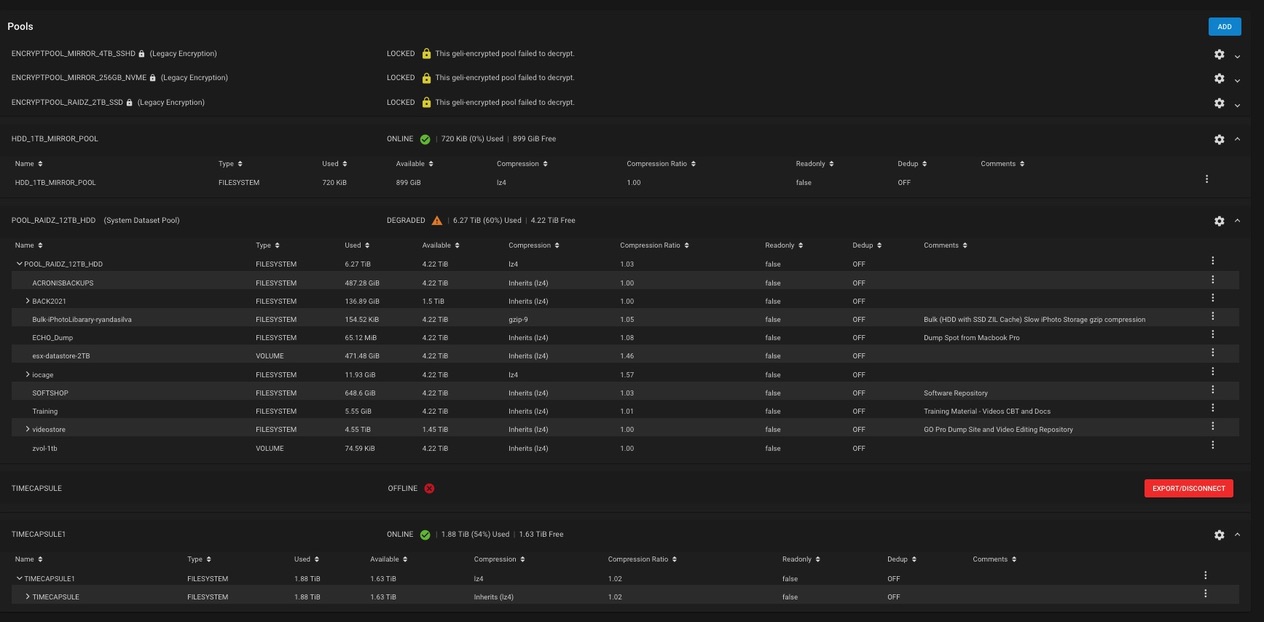

27
IVE NEVER BEEN SO HAPPY TO SEE THAT POOL SHOWING UP AS DEGRADED!!!! Yahoo! That pool has pictures and videos of my late wife and my kids early years that I don't have properly, fully backed up. i was in the process of organizing and ultimately having them backed up to the cloud when my pools shit the bed. I am going to make sure that they are backed up right now. Im almost afraid to spend another moment not backing that shit up to the cloud and ask about the the encrypted pools. I think I have the 3 key files .. i uploaded them to /data/geli after creating the geli folder but the filenames are similar to ENCRYPTEDPOOL_MIRROR_4TB_SSHD_BACKUP-GELI.KEY . i read somewhere that the filename needs to be UUID.KEY but I have no clue what UUID or where to get the uuid. Any help u can provide is greatly appreciated.
Ugh!! Im so relieved.
