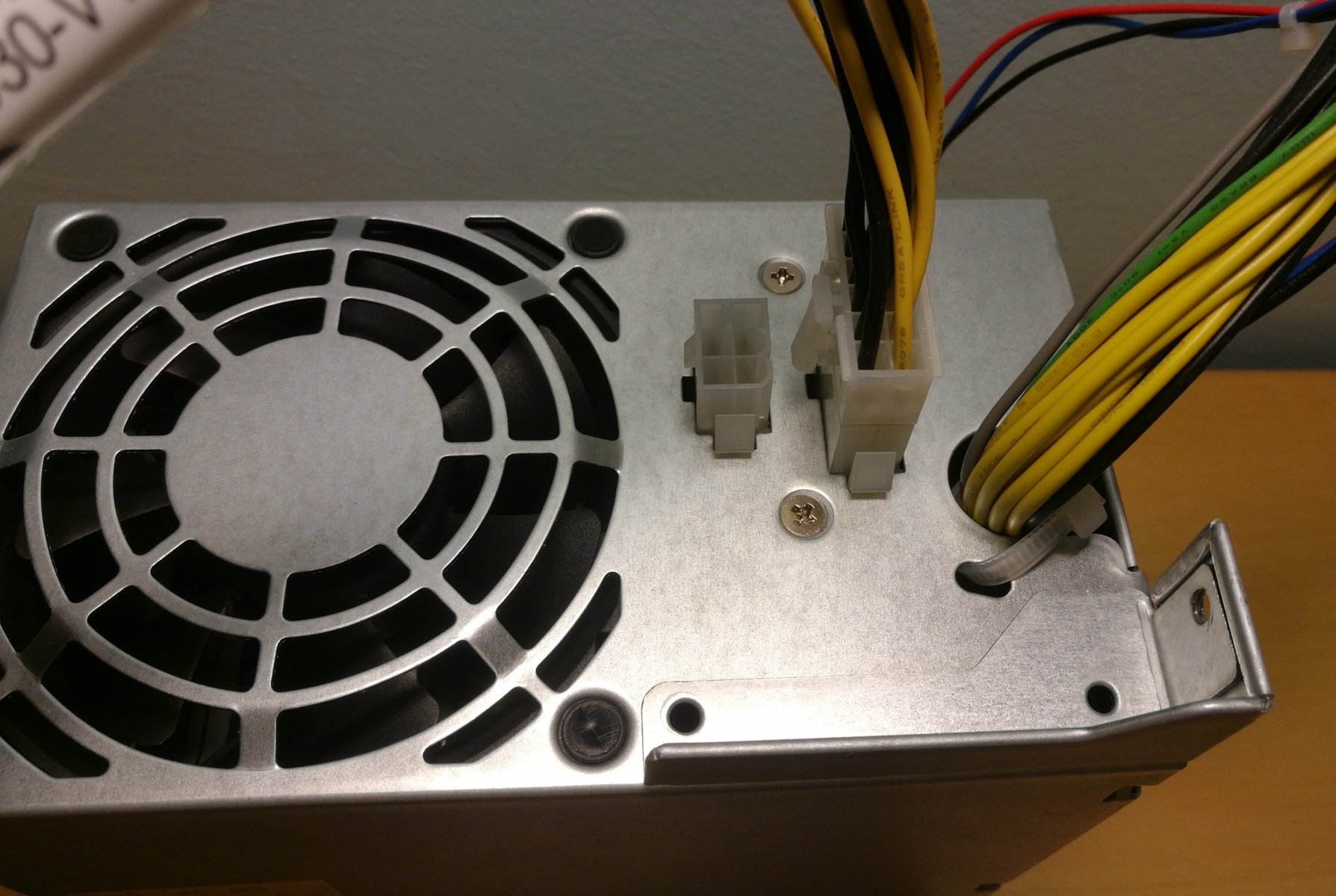

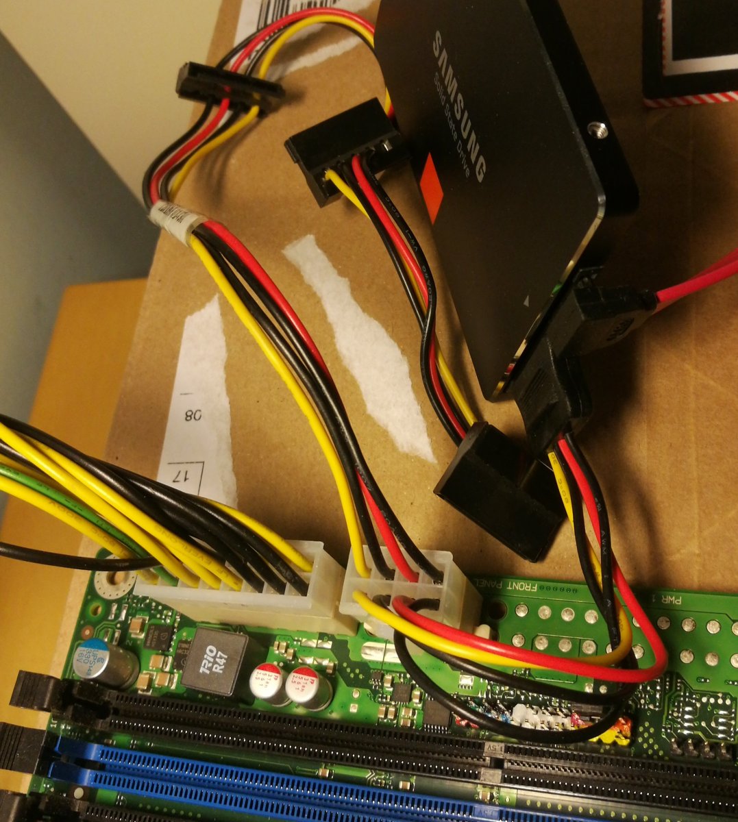

So I‘m building a NAS out of used bought system. And the PSU doesn’t has a 5V output. The mainboard has 5V out but only 2 lanes.
I can’t find the max 5V amps from the mainboard anywere.
Before my unraid card arrives I want to hook up 2 SSDs and 4 HDDs. I think that is still ok. But I want to use more drives.
What would be the best way to get 5V?
A new PSU is out because the Mainboard needs very non standard PSU pluggs I think.
Should I get a 12V to 5V converter? I’m very experienced with soldering.

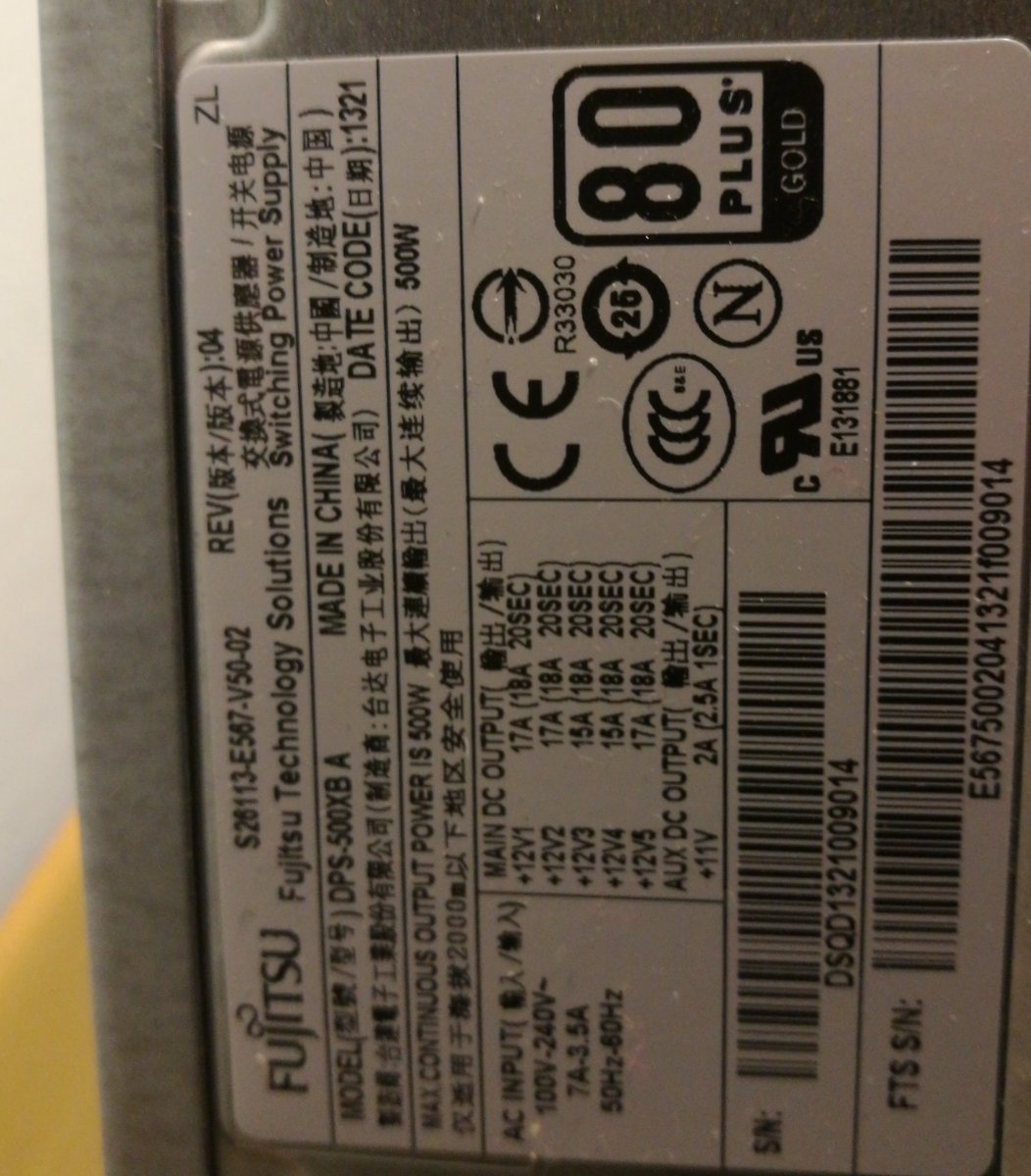

PSU: S26113-e567-v50-02 500W 80+Gold

IMG_20211022_191104.jpg PSU only 12V
IMG_20211022_191059.jpg mainboard power output to the drives

You can avoid it if you think it's worth the risk. Stepdown circuits from 12v to 5v are not hard to get. Amazon has them. And with a little bit of effort you can find schematics on the web to build them yourself. You just need to decide how much amps your itented drives need and which of the 12v lines you are going to split to feed those step down circuits. But a steady, reliable power supply is essential for a reliable computer. Being it a server or a workstation. I still think it's not advisable but it can be done.

I think I will buy a Meanwell 5V 10A PSU.
There is another 12V output from my PSU that isn't used so I will not have to splice things.
but maybe I will try to use my normal PC PSU and recrimp the plugs. The new board seems to only use 12V.
