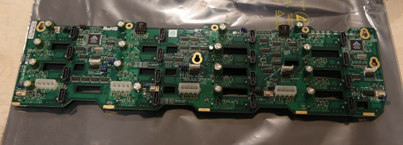

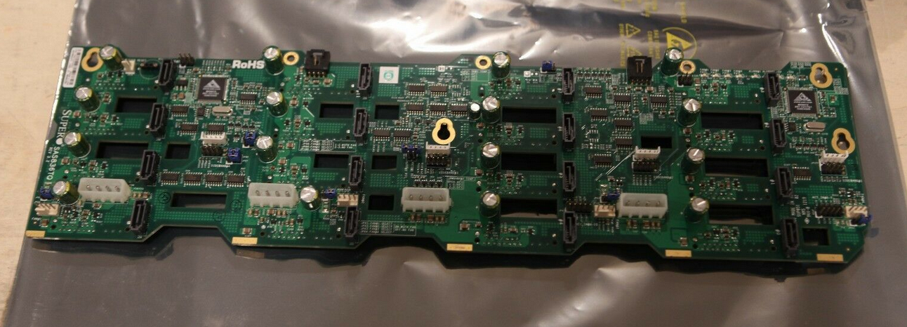

Do you happen to know if there are any limitations, in terms of bandwith, imposed by that backplane? That is does it 6Gb/s drives at that speed rather than downgrading them to 3Gb/s. The latter would only happen if the back-plane included SAS1 expander chip which I'm almost certain this does not have.
Also, it's SFF-8077 cabled rather than needing break-forward SFF-8077-SATA cables, right? Try as I might, I can't figure it out from the supermicro docs.

If we are talking about the link to a Supermicro 16 bay chassis that I posted, it does not have any limitation imposed.
The seller description says it is a SAS836TQ backplane. That means it is connected with forward breakout cables.
Looks like this on the back:
You have options with that, you can use a single SAS HBA to control it by adding your own SAS expander card or you can use two SAS HBA cards. I would go the expander route. The seller didn't show the inside of the chassis and they don't say if it is already cabled or not. I would hold off on buying cables until I got the chassis and look to see what is there.

I just noticed this. You can get a SAS HBA and a SAS expander for less than they are asking for this 16 lane card. It is really not needed, even if you are running an all SSD pool, you would want to go with a card that has PCI-E 3.0 instead of this older tech PCI-E 2.0 card. In this card the older PCI-E interface becomes the bottleneck to performance.

Thanks for clarifying the bandwith issue. The ad says its got a SAS836A in the title and a SAS836TQ in the body, hence my confusion. Unfortunately, I couldn't use an expander card as the C2750 MB only has one PCIe 2 slot. Useful video, nevertheless.
The expander card only uses the PCI-E slot for power, not data. There are many ways to provide power.

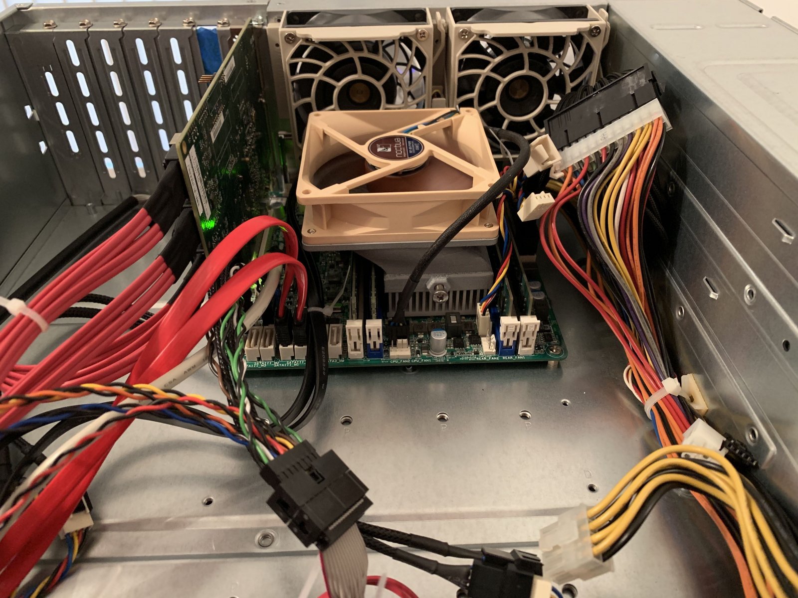

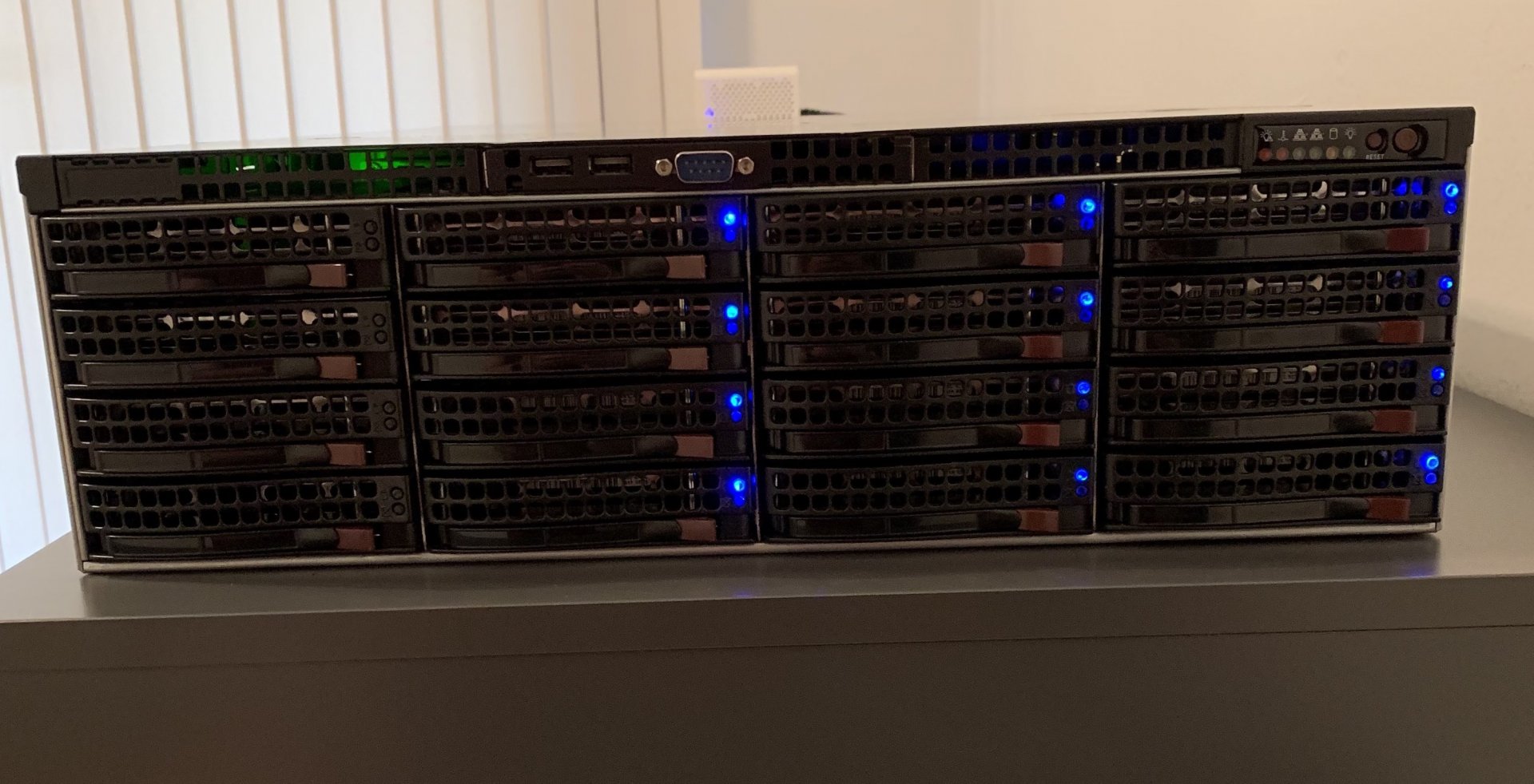

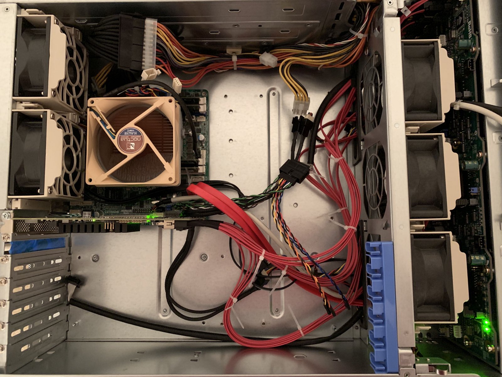

Update time.
I rebuilt the machine and it's been doing it's thing for about the last 2 weeks flawlessly.
The following is the parts list, some old, some new, and some old but new to me:
MB: Asrock Rack C2750 crowned with a 3D printed adapter and a Noctua NF-B9 to cool the CPU. The CPU on this MB doesn't appear to run as hot as my original board. I guess the coupling between the CPU and the cooler is much better this time round.
HDD: 6x3TB WD Reds in a RAIDZ2 with 6x4TB in a RAIDZ2 vdev. Stripped.
Boot SDD: 2x120GB SanDisk SSD; mirrored.
Jails SSD: 2x 240GB SanDisk SSD. Mirrored in a pool dedicated to jails, VMs and the system dataset.
HBA: 1x LSI SAS9201-16i flashed to the P20 IT firmware. In this case the flashing could only be done from the EFI shell rather than through FreeDOS. I have extensive notes on how to do this in case any one wants them.
Drive cables: 4x Mini SAS 36Pin (SFF-8087) Male to 4 SATA 7Pin Female Cable, Mini SAS Host/Controller to 4 SATA Target/Backplane
2.5-to3.5 inch drive adapters: 4 of these to fit the SSDs in the caddy slots of the case. The adapters work very well and are well built.
RAM: 2x16GB ECC Crucial Kits from the MB QVL
PSU: 2x980W Supermicro PSU that came with the case below
Case: Supermicro CSE-836 Chassis w/ 16x 3.5" Caddy
UPS: Cypberpower 1350VA
Other stuff that I discovered after the fact that were necessary
1x Motherboard power extension: The ATX power connector in the case was too short to reach the diminutive motherboard
1x bag of screws to secure the HDDs and SSDs in the caddys (Supermicro part #: MCP-410-00005-0N)
1x Supermicro 11.81-Inch 16-Pin Front Panel Split Cable (CBL-0068L) to connect the front panel to the headers on the motherboard.
2x fan splitter cables. There are more fans than there are headers on the MB.
I'm currently only using only one of the PSUs that came with the case. (They're noisy.) Together with a Cable modem, UBNT USG3, 8-port UBNT PoE switch, an UBNT UAP-AC-Lite and the UPS, the whole lot only draws about 118-120W when idle.

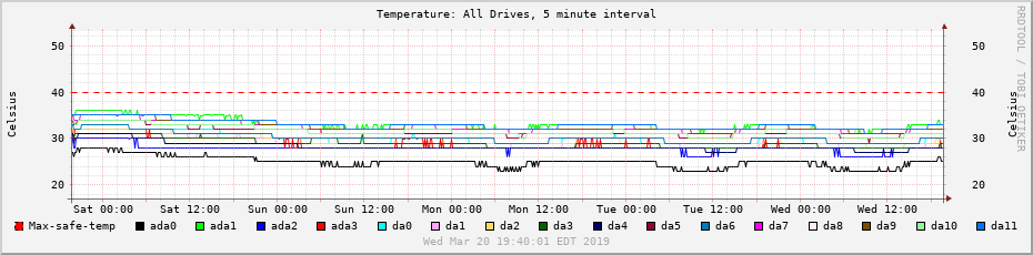

I've not messed with the fan profiles in the IPMI yet the drives are currently hovering around the 30C-ish mark.
Some pics are below:
