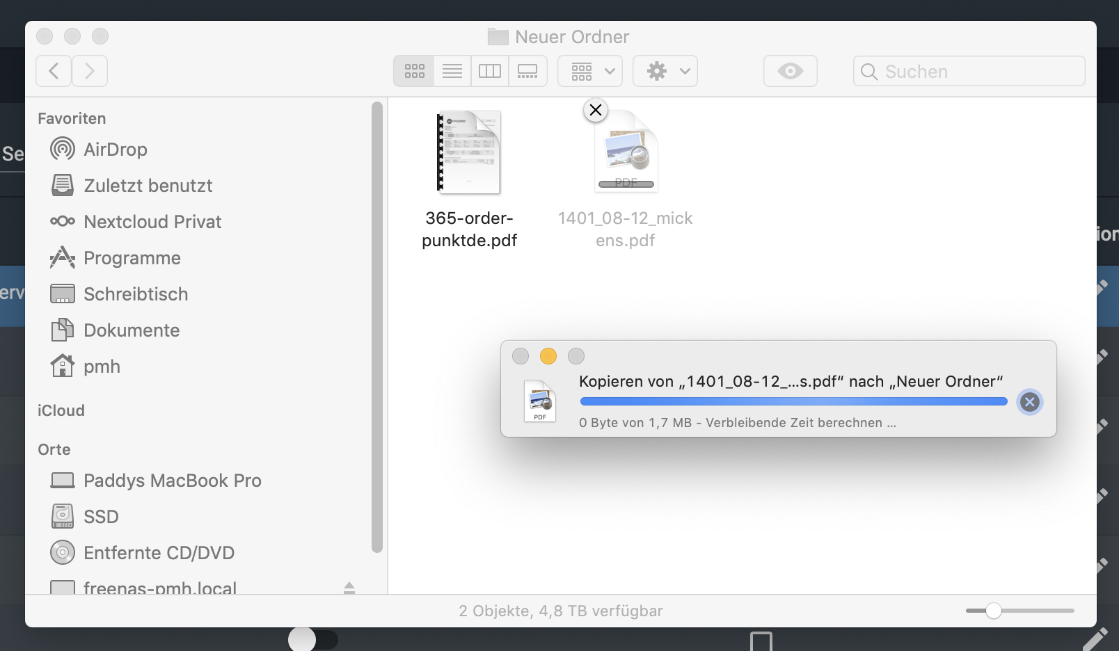

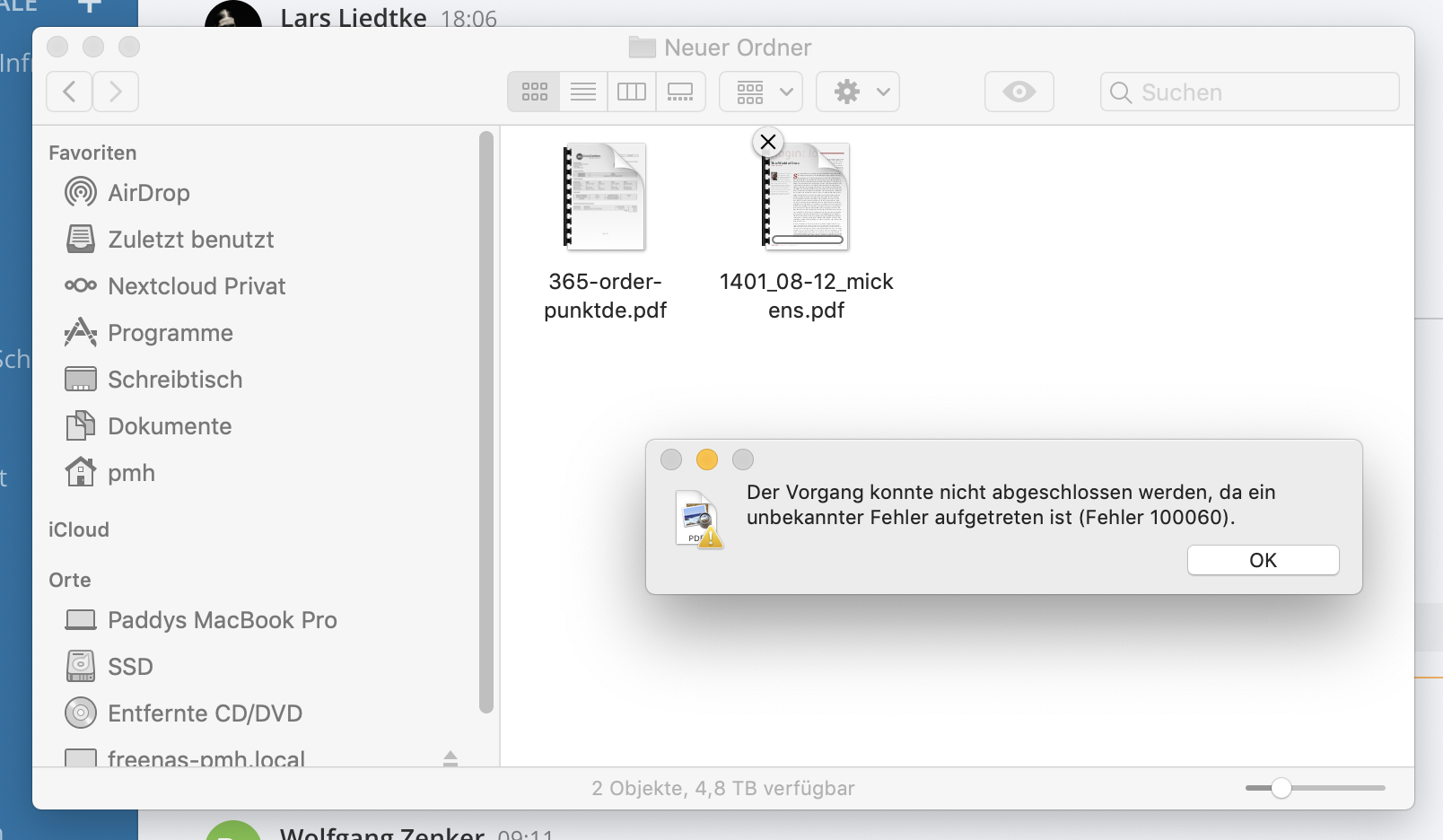

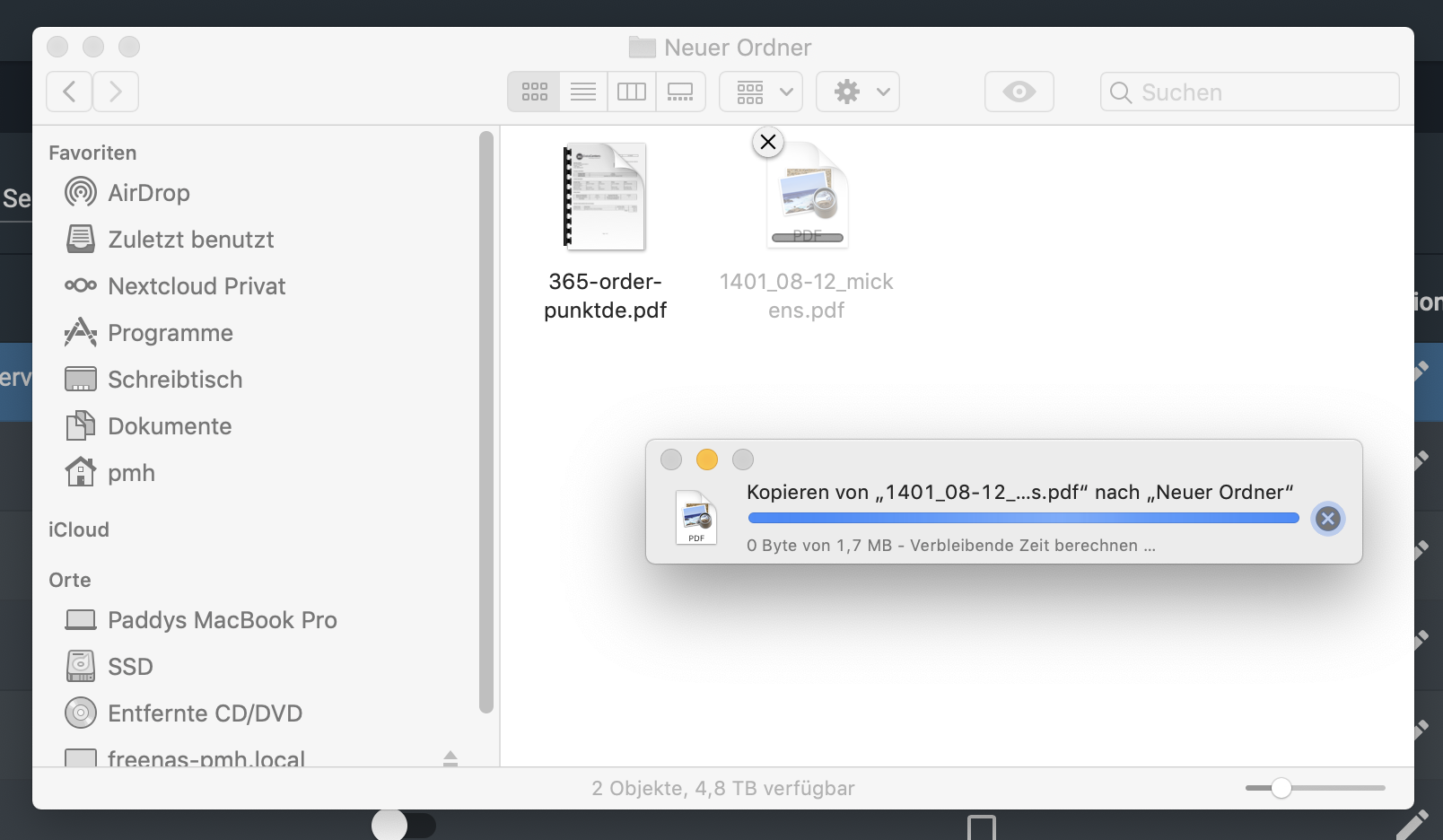

This is the situation with the last nightly (Monday evening):
Copying a file to the SMB share takes "forever" even for a small (1.7 M) file end results in an error message.
The file is copied nonetheless, it seems.
The file cannot be deleted because "the object is in use".
Mac OS version is Mojave, no authentication, all guest access at home.
Ejecting the mounted volume takes multiple attempts and "forever", too, but eventually works.
View attachment 39357 View attachment 39358
