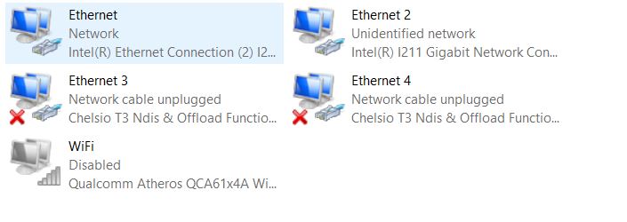

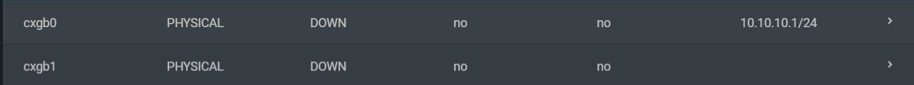

Hi Patrick,
So the problem seems to be the link between the two chelsios network cards. I installed them on my computer and freenas and they both seem to be working but there are no links when I plug them together (see screenshots attached). I can see the interface on freenas cxb0 and cxgb1. On my windows computer it's the same it detects the card but there is no link. I've set up all the pool and smb shares and they all work via the 1gb ethernet. So pinging only works with the 1gb ethernet but not with the 10gb, same for invoking it in windows.
Thanks again for your help!

Patrick M. Hausen
Nov 25, 2013
7,776
Then you need to check your cabling, obviously. If I am not mistaken you must use a cable with all 8 wires connected for 10G. If this is fiber instead of copper, you need to switch the two tiny plugs on one end to generate a "crossover" configuration.

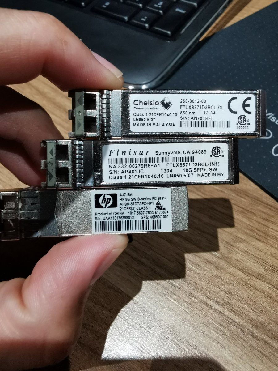

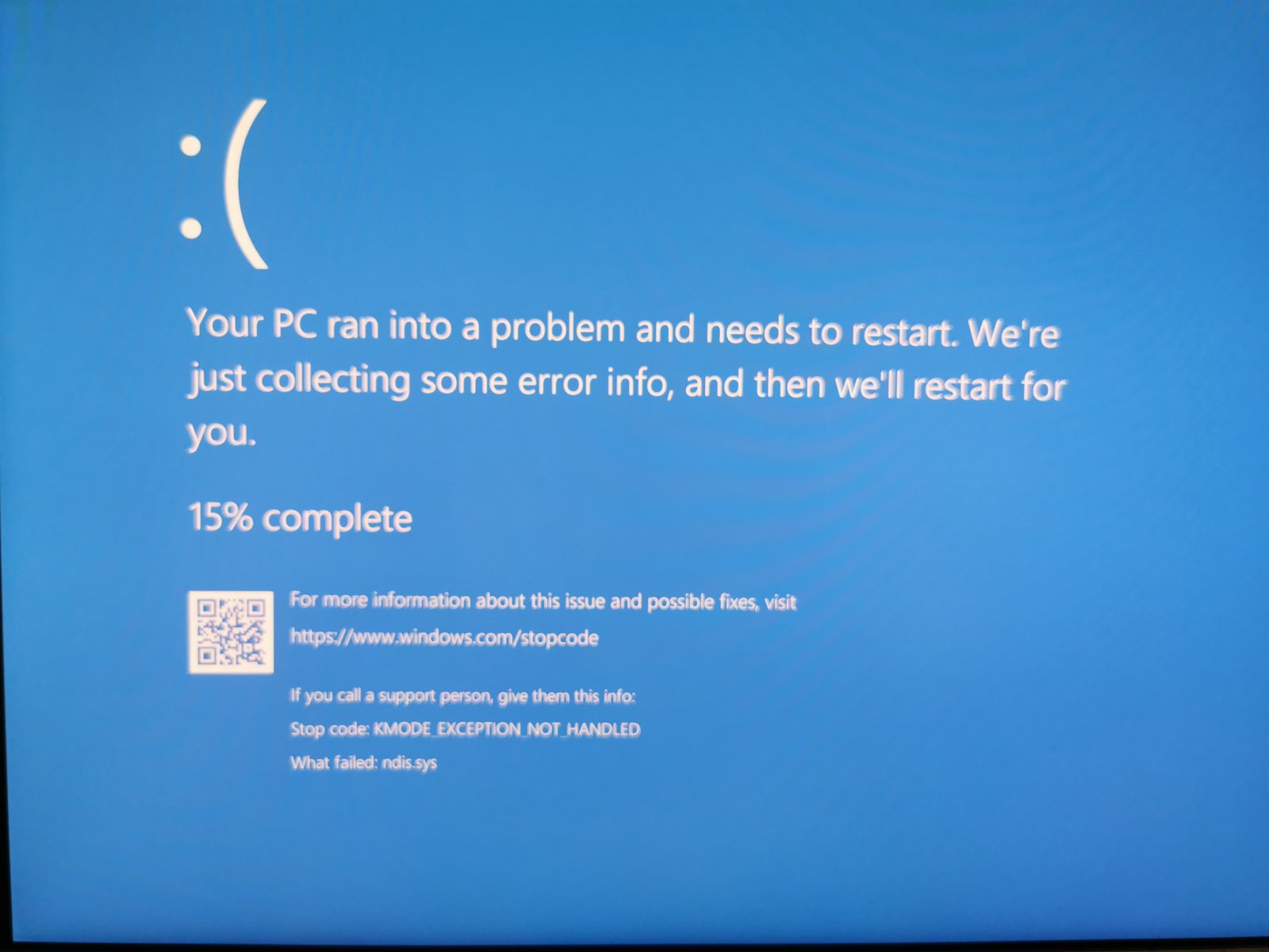

It seems to work now! I did the looping test c77dk advised on my windows PC and it made it crash at startup (BSOD), so I did it on the freenas and it actually worked, both 10gb were up and running. So I plugged one in my PC and it was actually working. Both on FreeNas and PC are connected. But as soon as I try to connect to the server on windows via the explorer I get the BSOD... I have attached a picture of modules I am using and of the BSOD.
Thanks again for your help guys!

Patrick M. Hausen
Nov 25, 2013
7,776
In that case contact the card manufacturer or reseller. I doubt anyone here can help with what looks like a driver problem.
Just one last hint: SFP+ modules are generally not mix and match, i.e. you should get matching ones from your card manufacturer (Chelsio) if they are reasonably priced or look for a trustworthy 3rd party vendor who offers "Chelsio coded" modules. But again, check with Chelsio what their cards accept.
w0rm220
Jun 28, 2020
5
I did try everything with the drivers and unfortunately I don't think there is anything I can do... I tried to contact the manufacturers yesterday but they don't do support for this card anymore. So I ordered the new Asus XG-C100F it should work fine with my motherboard and w10.
