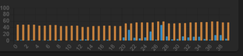

I'd like to try powerd++ because my load typically looks like the below image. According to the writeup I posted about how powerd++ works, one of the cores would be able to throttle down when it is idle, even though the other core may be working at 100%. This is not possible with powerd.
