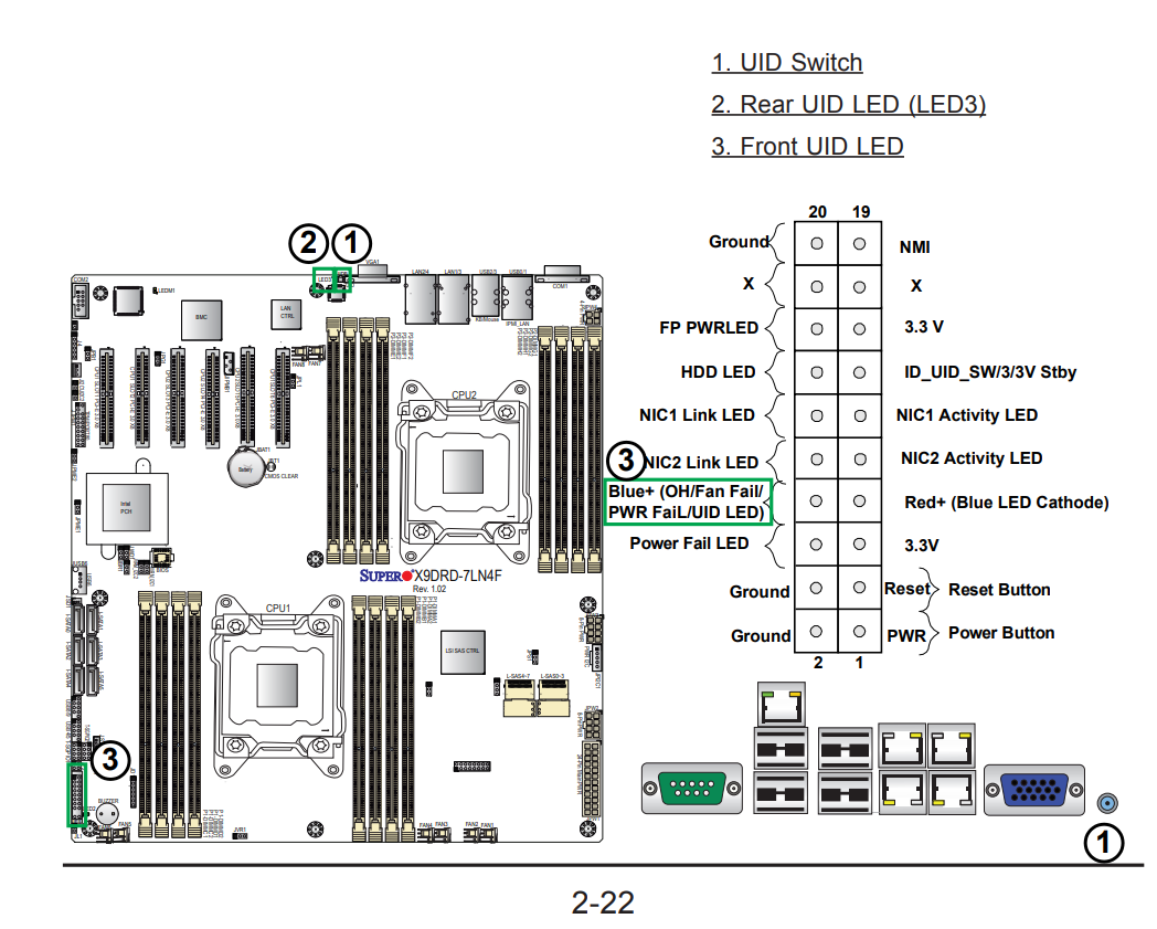

I got two used Supermicro PWS-920P-SQ power supplies that were recommended in the mail last night and popped them in with the same result. That is, the Power button does not apply full power to the motherboard or the rest of the computer. Although the green led at LEDM1 dose start blinking slowly once mains power is attached the power supplies.
Using a momentary switch on pins 1 and 2 of JF1 has the same result. Removing the Ram, CPU's and raid cards does not help. I have not tried attaching a video card because I do not have one that fits the MB.
